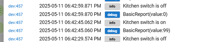

My kitchen aeotec nano dimmer. When i turn off at the wall. it reports back the status via BasicReport()

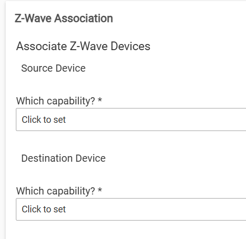

  • tried to change association via "Z-Wave Association Tool" found in package manager.
but it doesn't allow me to choose hub as the destination device. Hence cant set Laundry association to hub.
