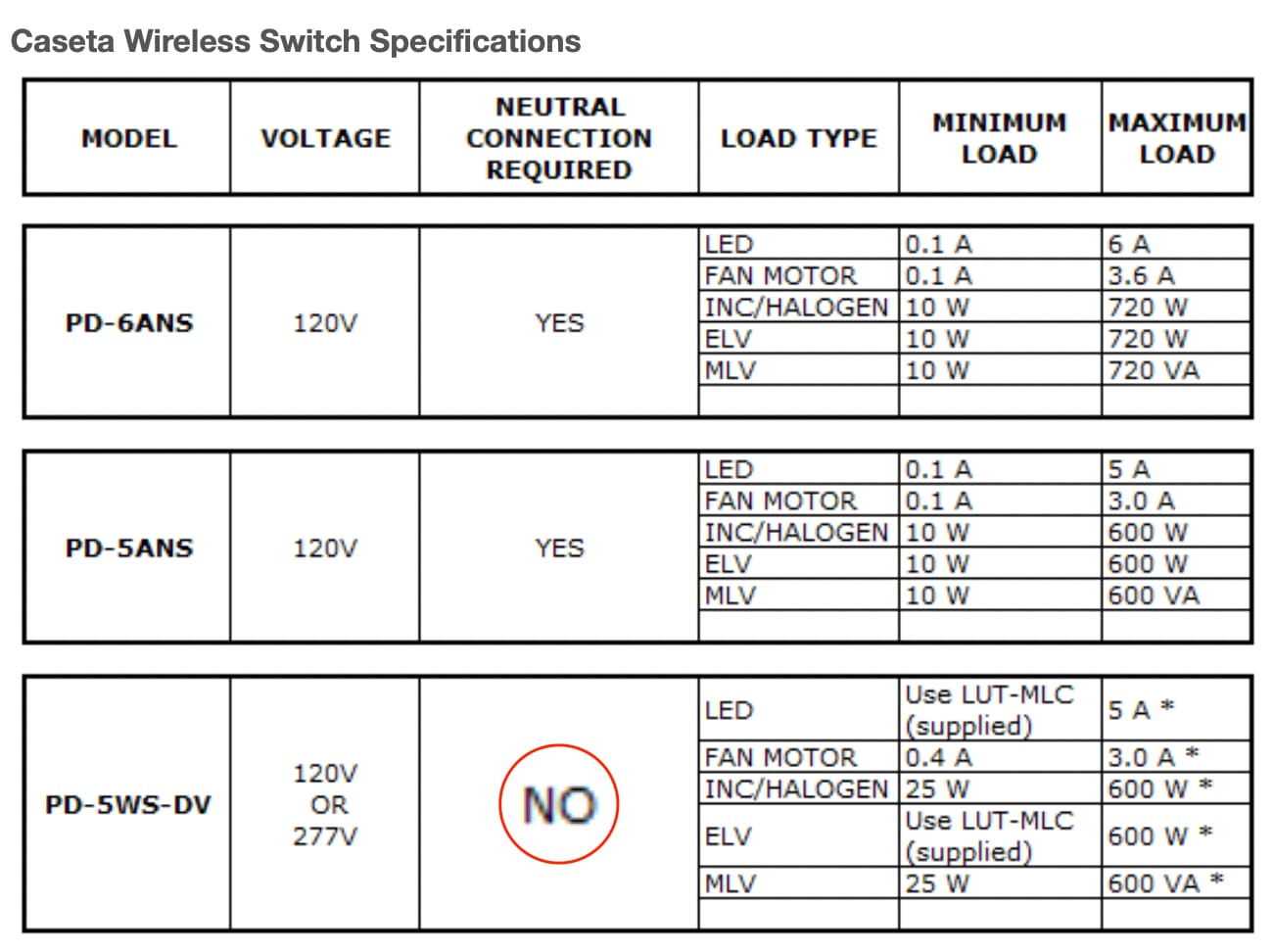

I use all lutron dimmers (no neutral) and switches. For recessed lighting I use commercial electric (home depot). For bulbs for the occasional table lamp I use Lifx. For our kitchen chandelier I use these
