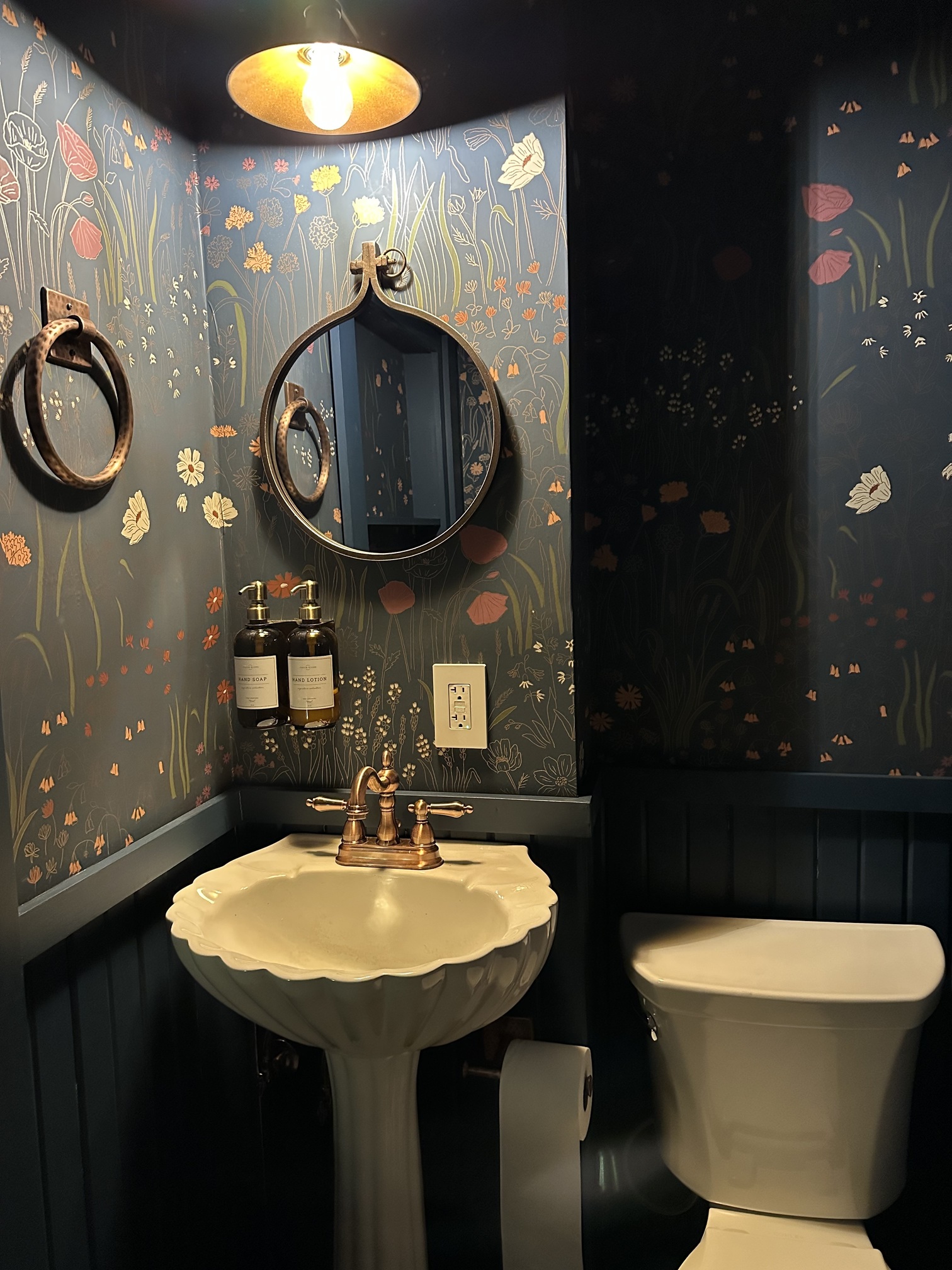

We have this shelf in our powder room that I need decorate.
I wanted to add a little bit more ambient lighting, but there is no outlet anywhere. I bought this cheap mini lamp powered by 2x AAA batteries and I was going to stick a Sengled Zigbee bulb in it (after converting it from E12 to E26).
How long do you think the batteries will last?
P.S. I am open to better ideas for the lamps by the way. I did at least managed to grab some battery operated under cabinet motion sensor lights that I'm praying work.

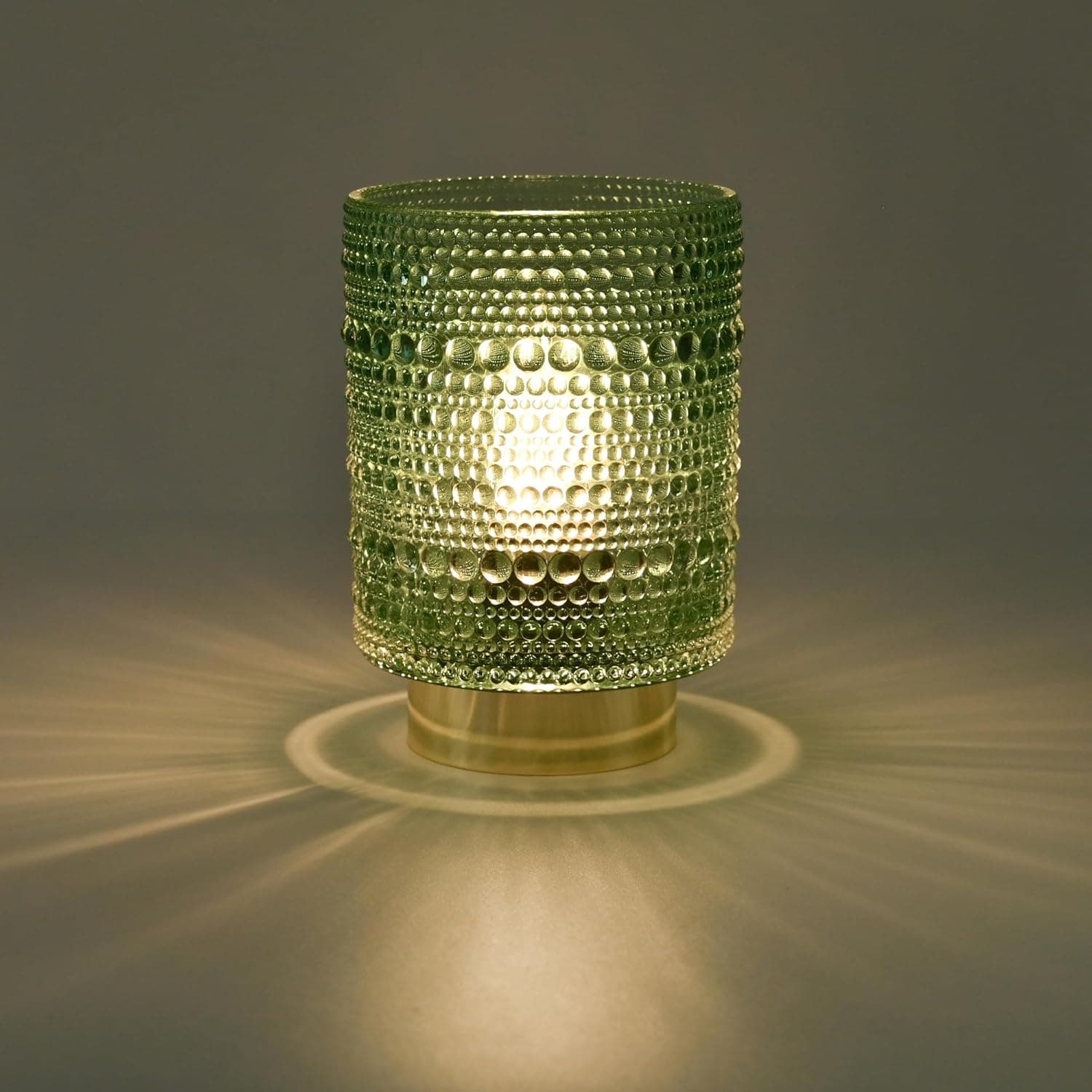

Look at Christmas window candles or other battery candles. They last quite a while on 2AA batteries (I can run mine for about two weeks from 4pm-10pm, so somewhere around 50 hours. I control them with Hubitat via a Broadlink IR blaster using the local wifi Broadlink community driver. Just get some battery lights that come with an IR remote if you want to automate a battery powered light.

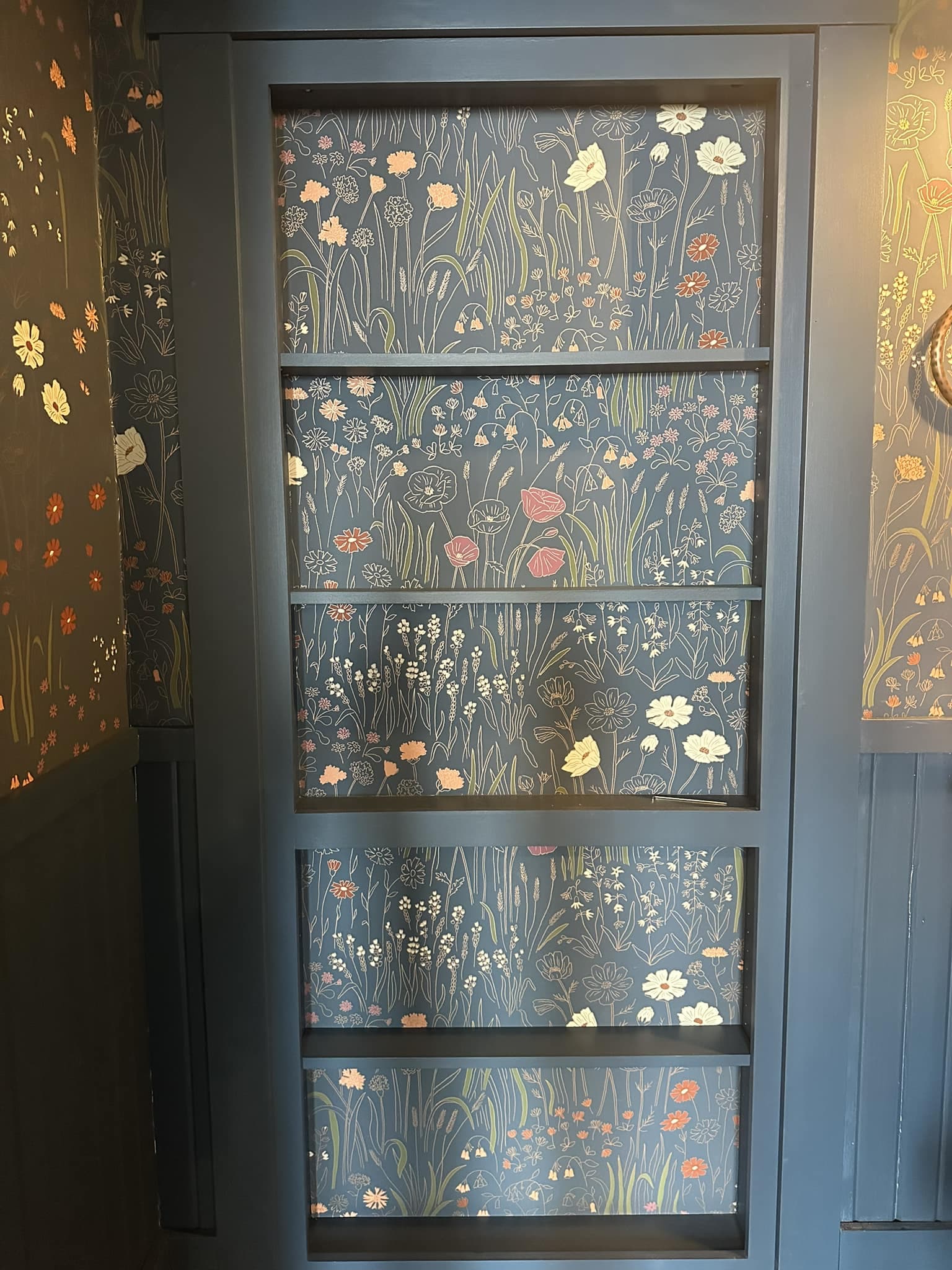

There’s actually another outlet but it’s behind the Murphy door. That would mean it’s literally less than 4 ft away but I have no idea if that door will be an issue.

This is perfect! Thank you again for helping me with all of this! So battery operated LED candles with battery powered IR blaster it is!
