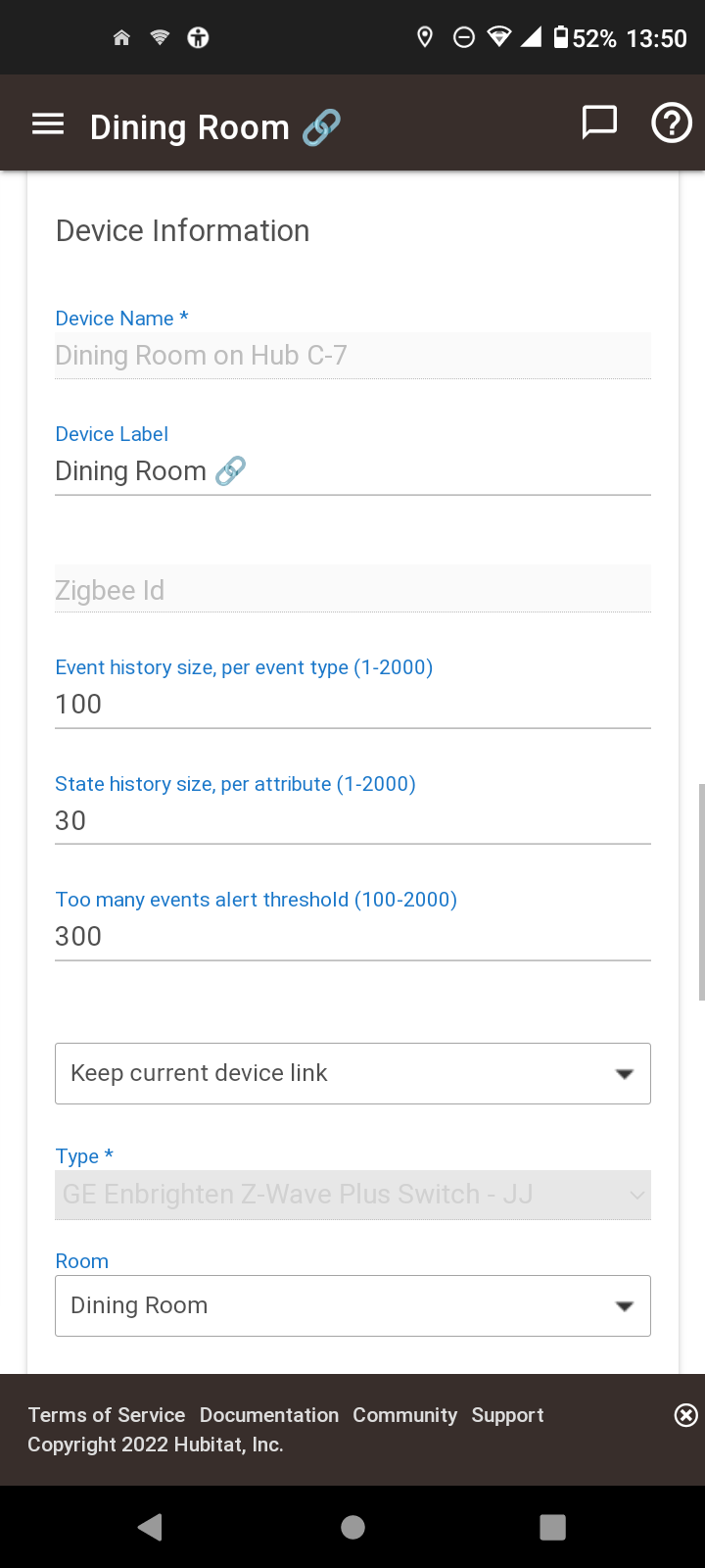

I'm pretty sure if you enter something in Device Label before allowing it to be used a by Alexa, she will use Label instead of Name. That's what she did for me. I add the chainlink emoji to label of all of my meshed devices to indicate that device actually resides on another hub.
Indeed she will. I think OP was looking to avoid that hassle, but it may be the best way.

Yes...that works for me. This is a much more intuitive place to manage these names. Thanks for sharing.
I am a newbie when it comes to creating a mesh -- only been at it a week. I know I did try to select the Device Name field before and found it locked. As the field is greyed out it made sense I should not be able to edit it. As Device Label is also greyed out I didn't attempt to modify it till now....
