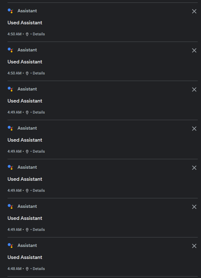

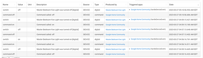

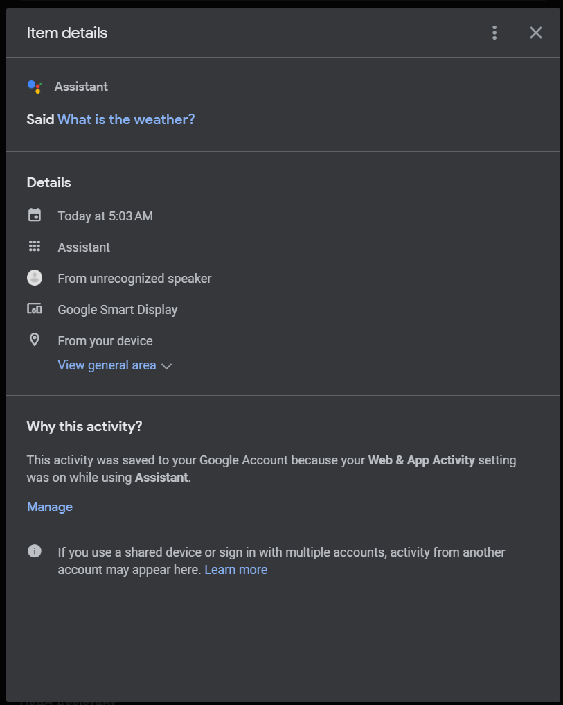

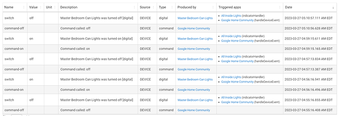

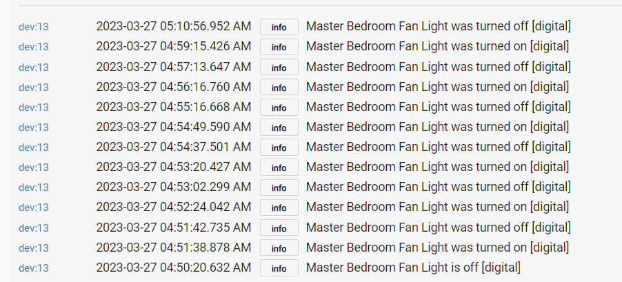

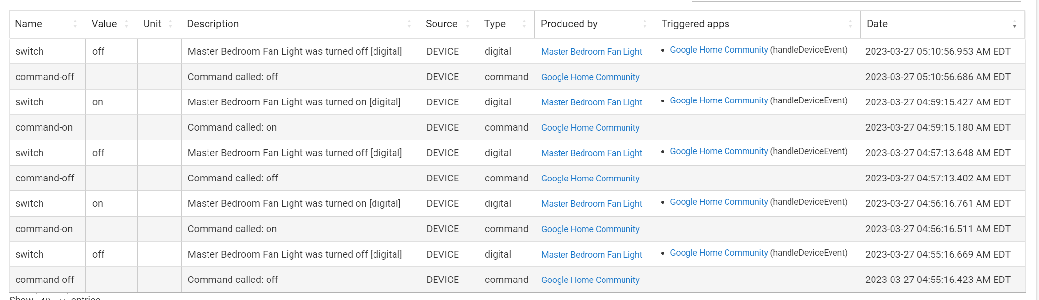

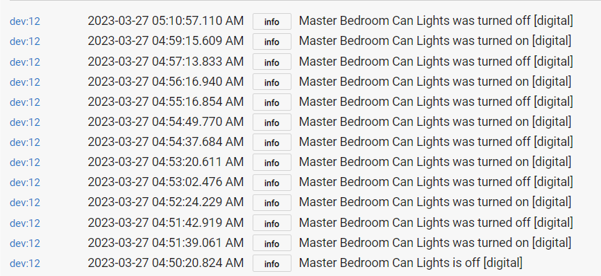

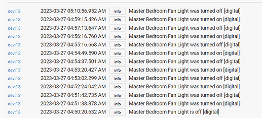

So, I've got a weird one. This morning, around 4:50 am, the lights in my bedroom flashed several times while my wife and I were asleep.
So, I check the device events and see they all originated from this app (at this point, I really don't think the app is to blame).

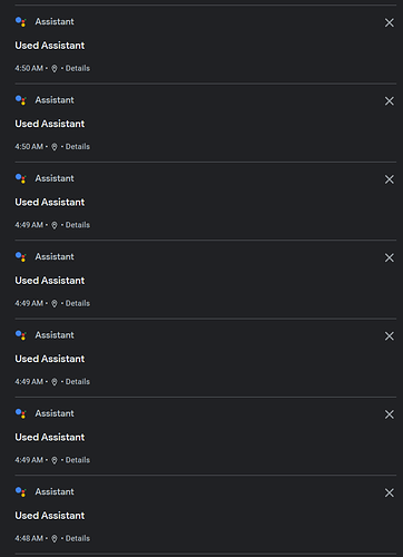

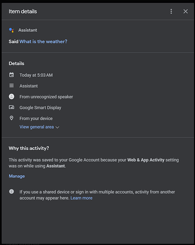

Since, I don't have debugging turned on, I checked my Google activity feed and see:
The location is correct for my house

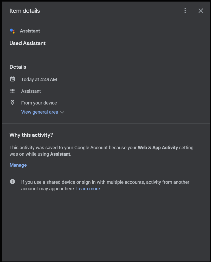

What's odd from the Google activity feed that correlates to the lights toggling is that the "used assistant" events just show "from your device" instead of showing which device.
I also see activity like this
I checked the cameras that are able to pick up audio from the bedroom and don't hear any interactions happening (although I need to go over this a bit more).
So, my point in posting here. Has anyone seen something like this before? Are there any other avenues of data gathering I can take (besides seeing if Google themselves can provide any additional info)?

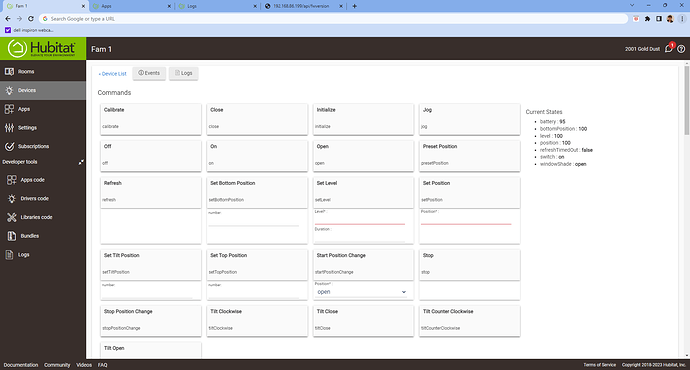

That error indicates that the app can't read a value for the attribute you configured as your blinds Open/Close Attribute. Check the Open/Close trait of your blinds device type and make sure the Open/Close Attribute is set to an attribute that appears under the Current States heading on the blinds' device page.
Found it. Toggled "Discrete Only" and that fixed it. Thanks for pointing me in the right direction. Great app!

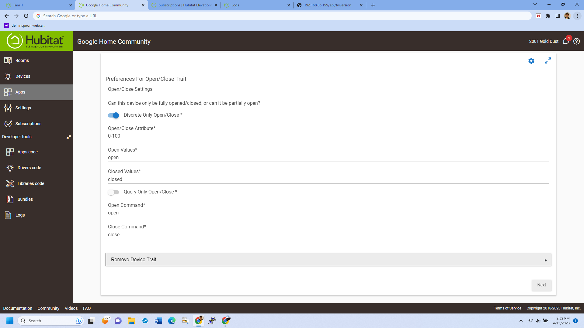

I lied. It showed that shade(s) online after that, but I keep getting an error. Here is my device and setting in GHI.
This is the setting when it shows "Offline"
This is the setting when it show online, but I still get errors when controlling the shades:
The "Open/Close Attribute" setting needs to be the name of an attribute that the app will look up the value of to determine if the shade is open or closed (or how open it is, if the "Discrete Only" toggle is turned off). In this case, it should be either:
  • windowShade if you turn the "Discrete Only" toggle on, since that's the attribute that reports the discrete open or closed value of the shade
  • position or level if you turn the "Discrete Only" toggle off, since those attributes report the percent of the way the shade is open
For most traits I tried to give reasonable defaults for these sorts of attribute settings. Sadly the Open/Close trait maps to several different Hubitat device types that all use different attribute names (contact for contact sensors, door for garage doors, windowShade for shades, etc) so there wasn't really a good default to pick. :frowning:
You're the best! Works great now!

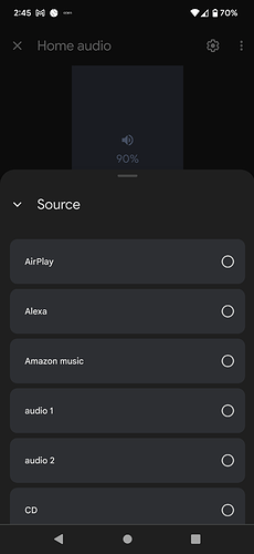

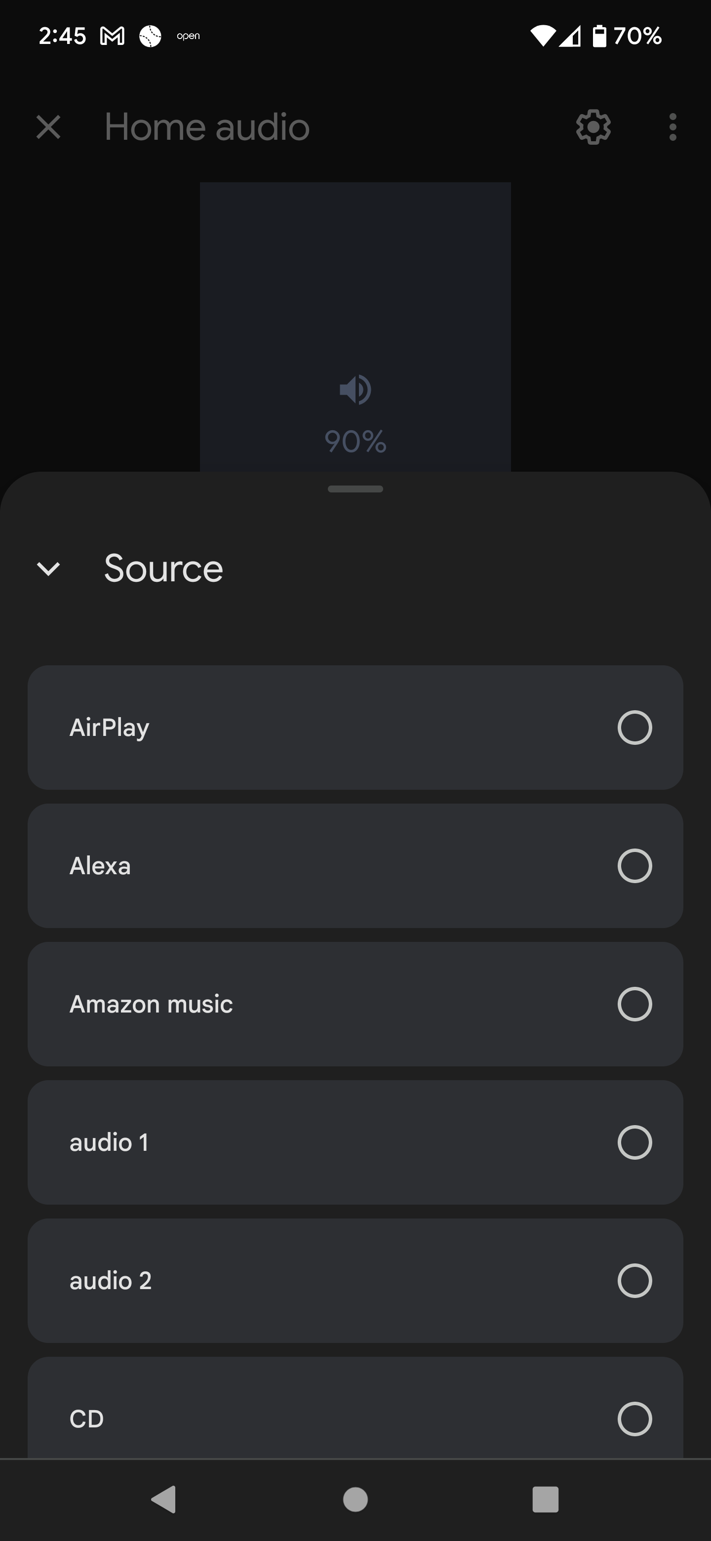

Again, amazing job on this app. Wanted to throw something out that I recently saw after getting my parent's Yamaha Musicast linked with GH. To note, this is a direct link between GH and Yamaha not through HE.
When I open the Yamaha receiver in GH (long press) there are the usual volume, play, mute functions, but further down there's a source button. When you press it, a window opens to select the input (see photo below). Is there a way to get this trait implemented in to this app?
TIA
@BorrisTheCat You should just need to modify the client ID, client secret, and fulfillment URL in your Google Action. See the setup instructions for the values to use. You may also need to re-link the integration in the Google Home app (devices -> add -> works with Google -> tap your integration -> reconnect account).
@curtman3 I'm guessing that's the InputSelector trait. I've been putting off implementing that while I think of a way to make the code generic so that it can work with AppSelector, Channel, and Modes (and possibly some others) as well since they're all essentially the same structure. I'll take another crack at it and see what I can come up with.
