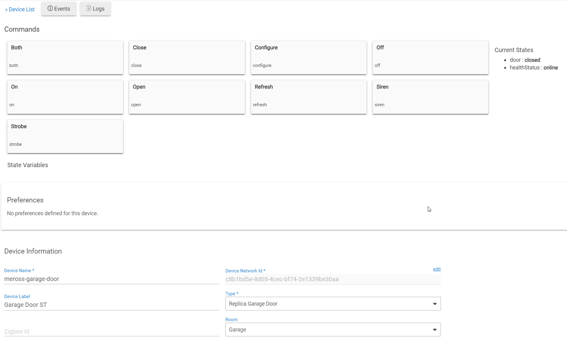

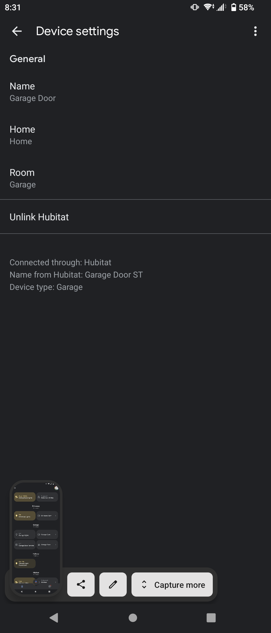

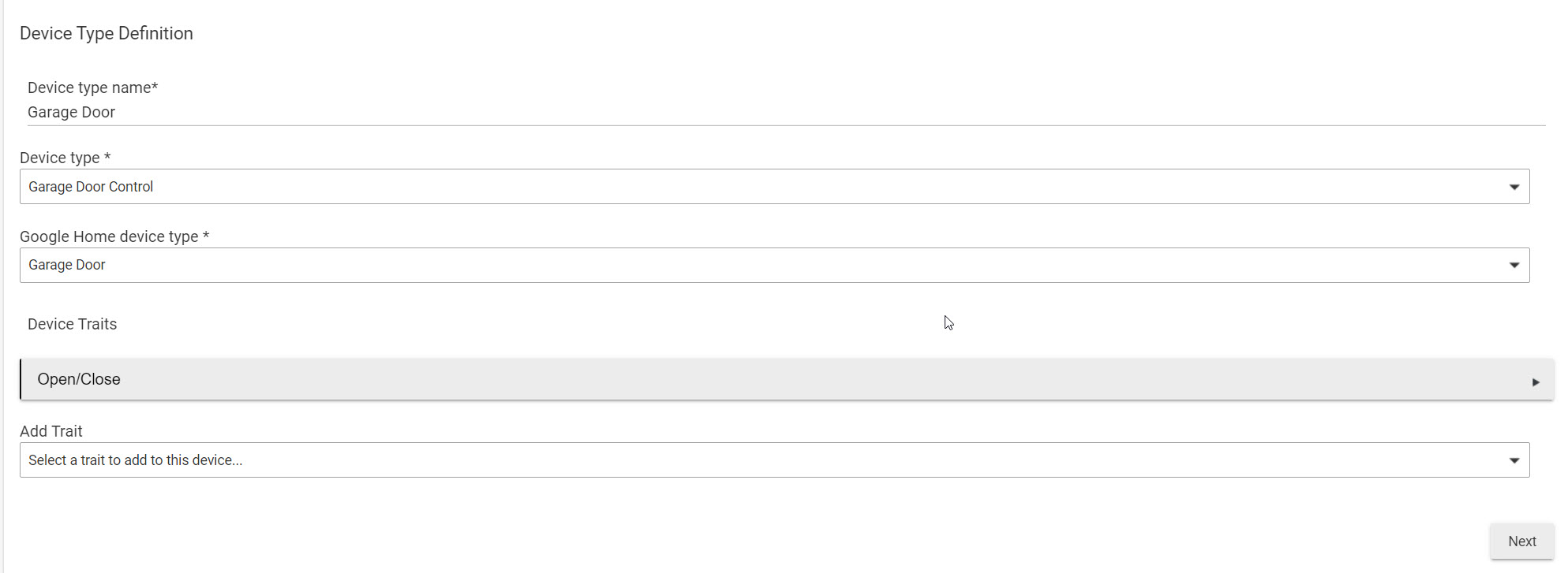

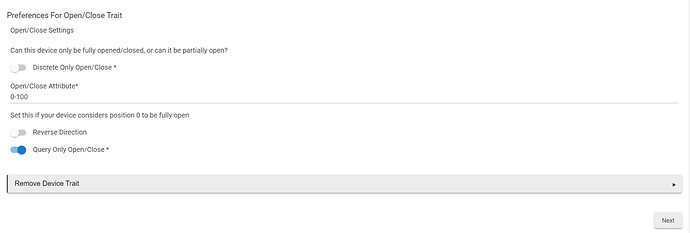

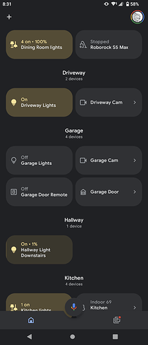

so I'm having a weird issue with my garage door. I'm pretty sure I have Google Home Community setup properly in Hubitat. Also I can command the garage door from Hubitat just fine.
But in the google home app, I can't control the garage door. It shows up in the app, but theres no controls and it doesn't report the status of the door(open or close).
If I setup a virtual switch in hubitat and have that mirrored into google home, I can control the garage door with that(Garage Door Remote in the screen shots below).
Any ideas? Is this just a limitation of Google Home?
Thanks in advance
Yes, I believe that's a limitation of the Google Home app. If you can tell the Google Assistant to open/close the door and ask about its state via voice commands then that should mean everything is set up correctly.
EDIT: I just looked at your screenshots again and your Open/Close trait doesn’t look right. You should have the “discrete only” toggle enabled since your door can only be fully opened and closed, not partially. Also the “open/close
attribute” should be “door” since that’s the attribute Hubitat uses to track the open/closed state of the device. Also, if you want to be able to control the door via the Google Assistant then you need to turn the “query only” toggle off.
Thank You! those settings did the trick. Now I can control the garage door through the google home app.
