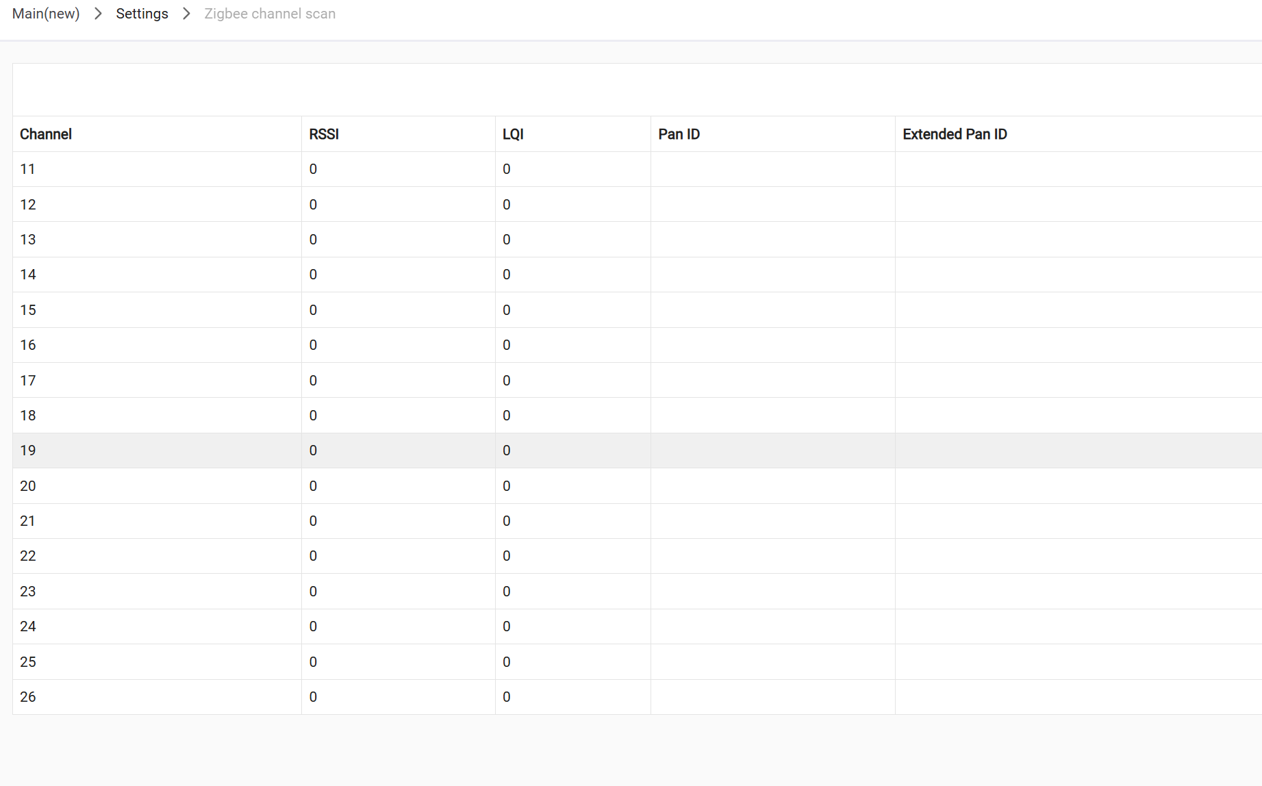

channel scan is empty.... Hub is on 20 pwr 20, I upped it from 8
The HE Channel Scan is known to be inaccurate and not particularly helpful, so it's best to leave it as it is.
Increasing the C-8P transmit power to level 20 is also not recommended. Doing so creates an imbalance between the hub’s power and the devices’ power levels, which can lead to hard-to-diagnose issues. Keep it at the default level (8). Later, once you have a solid Zigbee mesh, you can even try lowering the C-8 power level to 4.
