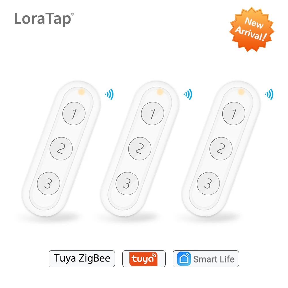

Actually there are cheap options, the sonoff SNZB(zigbee version) and the Tuya 3 button device and the smarthings button(not made any longer, try ebay)
