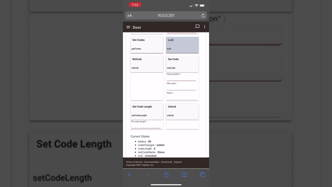

I have a DB2-B and I just went to the device page and locked and unlock and it updated under current state just as my pushover notification came through both times.
Steve
Thanks. Now I'm really confused. Is your lock using “Alfred Z-Wave Lock” as the type? Did the change in state show pretty quick or did it take time?
Hi. It’s pretty quick. As I said same amount of time that I get my pushover notification.
Maybe I can record the screen.
Yes, thanks. Looks like the refresh takes about 3-4 seconds which is fine. I've waited a minute with no luck.
It appears you have a C7 hub and I have a C5. Not sure if that means anything.
