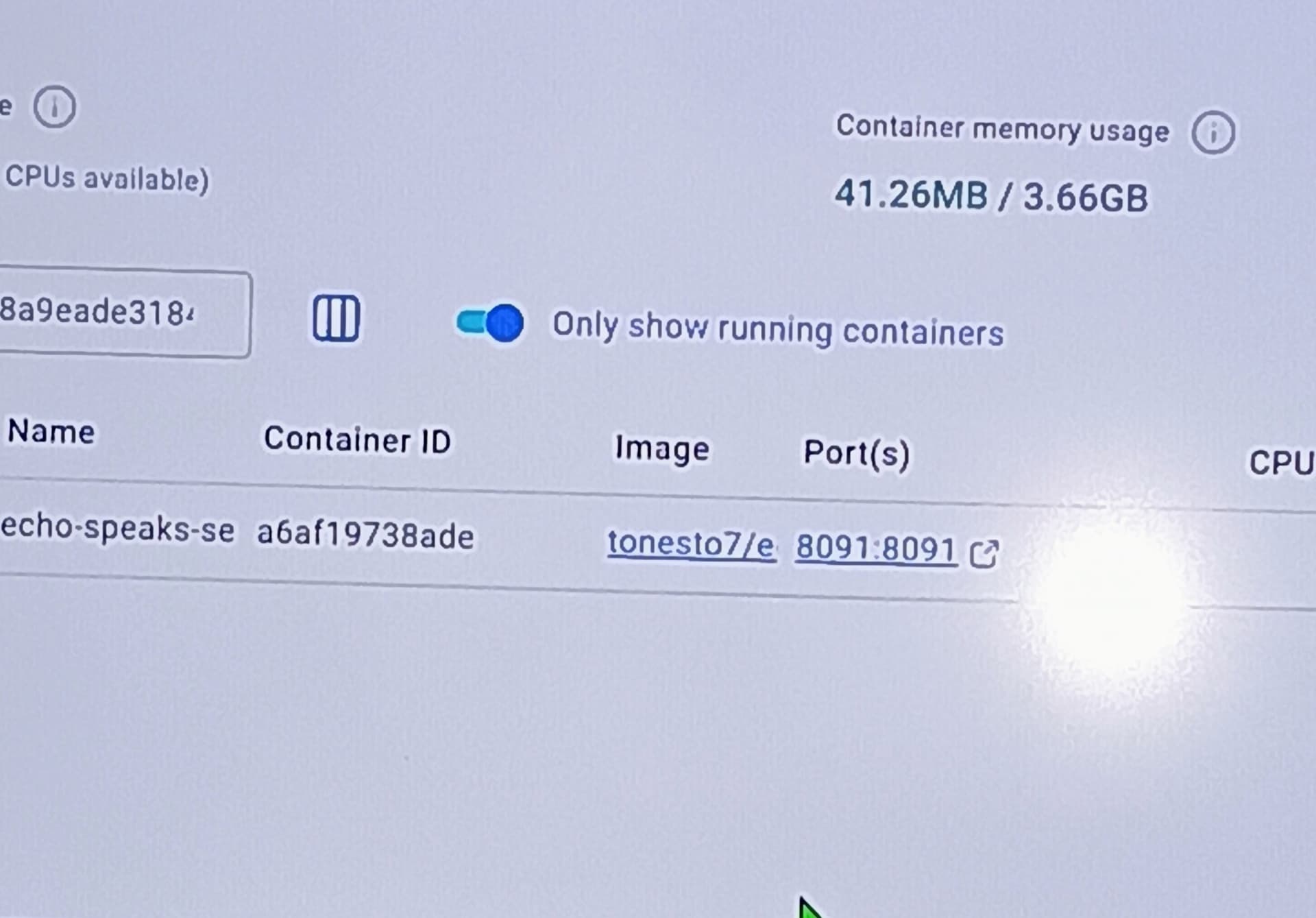

I think one of your issues before was your docker server changed its IP, I am sure we told you to give it a fixed IP in your router but maybe that did not happen.
The internal container IP does not matter. The host IP of the server running docker needs to stay the same or things wont be able to find it again if it changes.
I did reserve an IP. I must have hit something in docker
I got it back. Must have switched containers

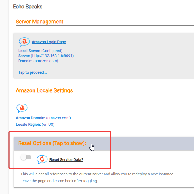

How do I get to the new callback url?
That should only happen if you delete the container and make a new one....
You probably need to do this reset in ES (on Hubitat) and then re-connect it to the new cookie server.

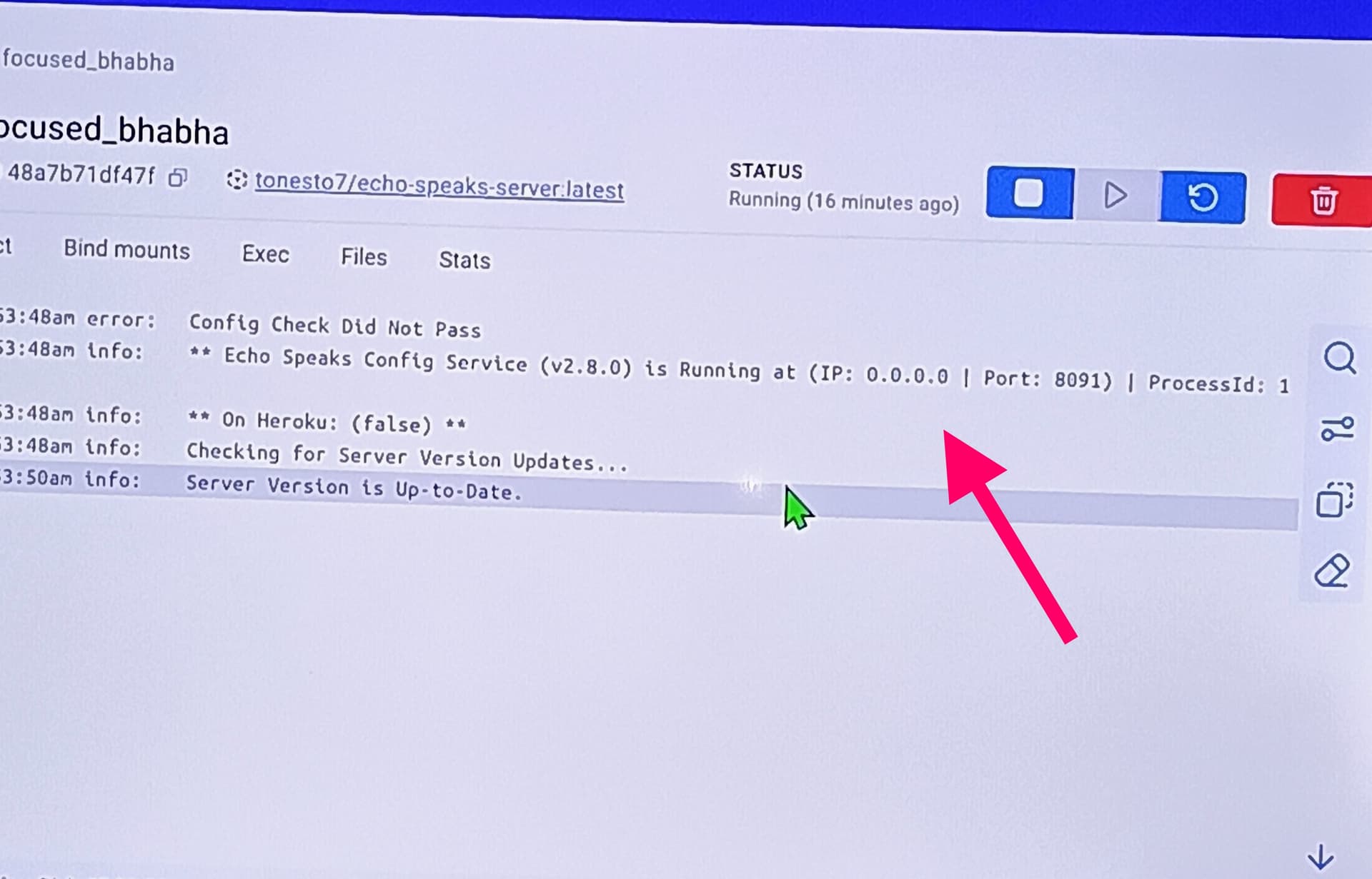

Ok I think I got it
I changed my servers IP to the IP that was stated on the echo speaks cookie login. The cookie refreshed.
Let's see it it continues.

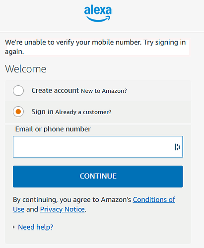

I cannot login to the amazon service: I keep getting cannot verify phone number . Everything is verified. Anyone have any ideas? Thanks
Can you use your email address?
I tried that,
