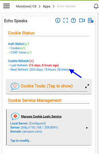

Just noticed it not showing the ip

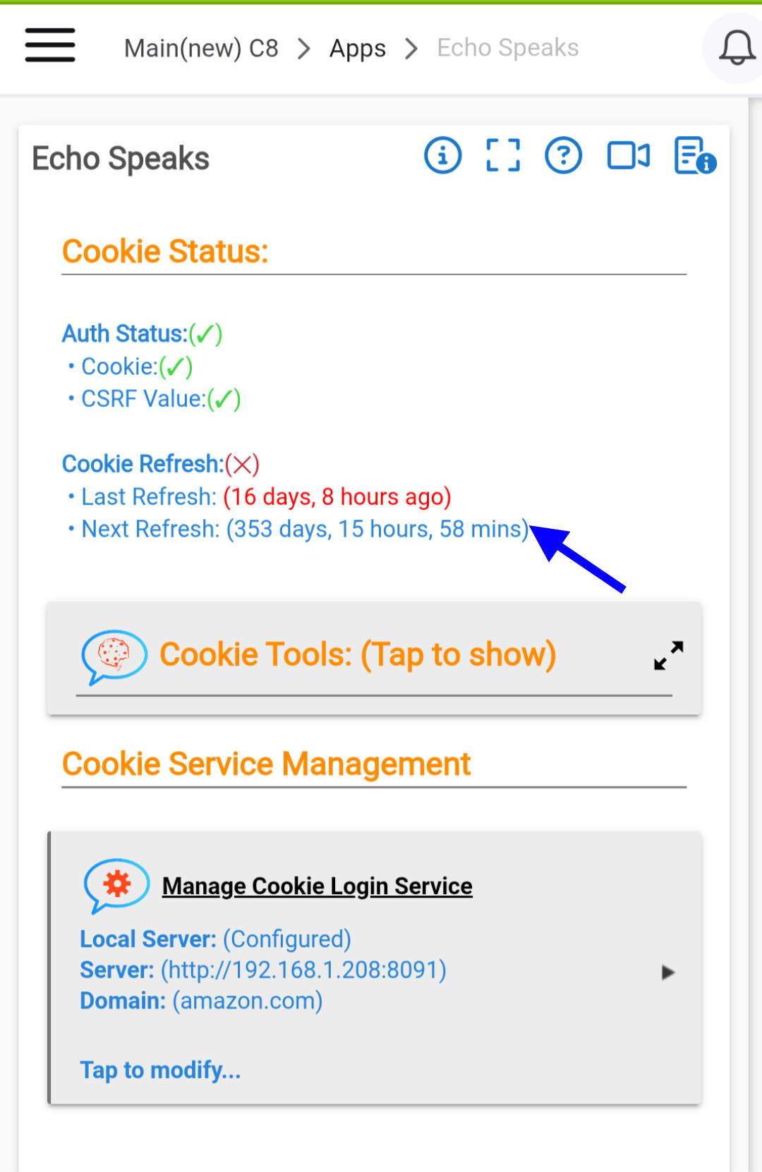

It’s visible in the screenshot you shared.
“Cookie Tools: (tap to show)”
Judging only by the screenshot, it looks like you have a valid cookie but your server didn’t refresh the cookie when it was scheduled to 16 days ago.
My guess is your server stopped running again. But that’s just a guess.

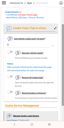

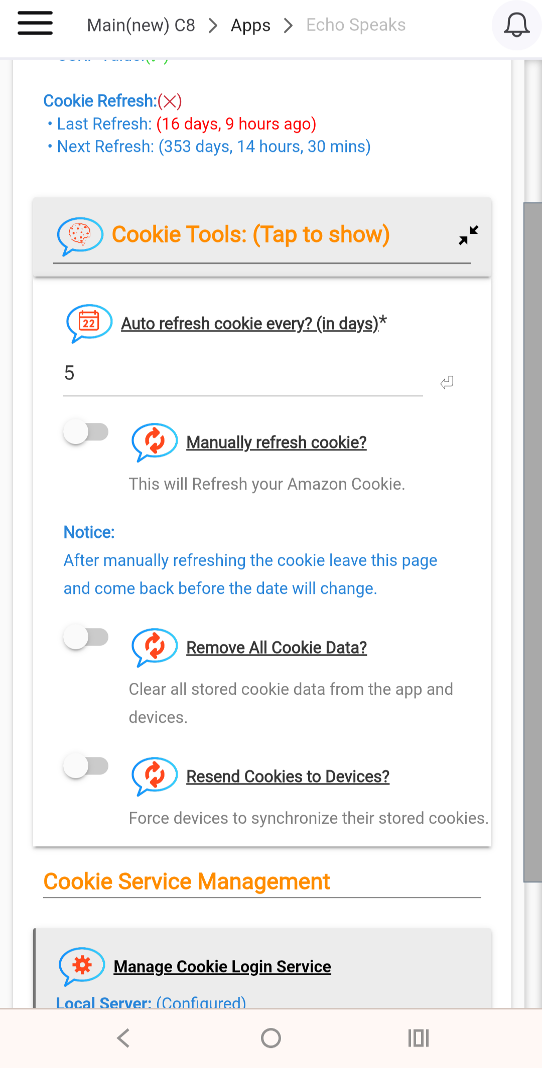

It shows 5 days. Is it set correctly?
There is no “correct” setting. Only the setting you choose for how often the Alexa cookie gets refreshed. Or the default that the developer chose, which is probably five days.
Your cookie refresh server apparently isn’t refreshing the cookie every five days, though.
Probably because the anerver isn’t actually running. But that’s only one possible reason I suppose.

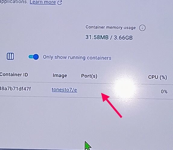

Ok I restarted docker container and not sure what I did but now it seems the ports are missing. How do I correct?
If its running in host mode on some sort of linux system there wont be any forwarded ports. Windows only works with bridge mode. It should not lose any configuration if you only restarted it.
