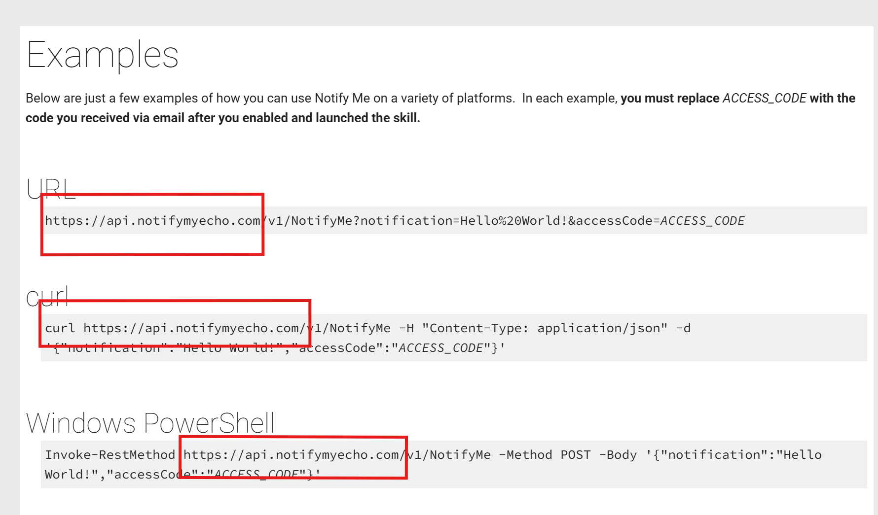

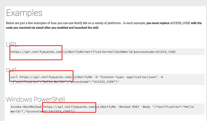

I haven't used it, but did a little research on it. It looks like it offers a decent feature set. However, my biggest concern would be handing over an API Key to a third-party cloud service that possibly grants them a little too much access to my Amazon account... :thinking:
From their examples, it appears you have to send a request to the 'notifymyecho.com' cloud server.
Thanks - yea just started looking at their site and looks like you need to be running Node Red or tasker, etc first

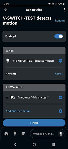

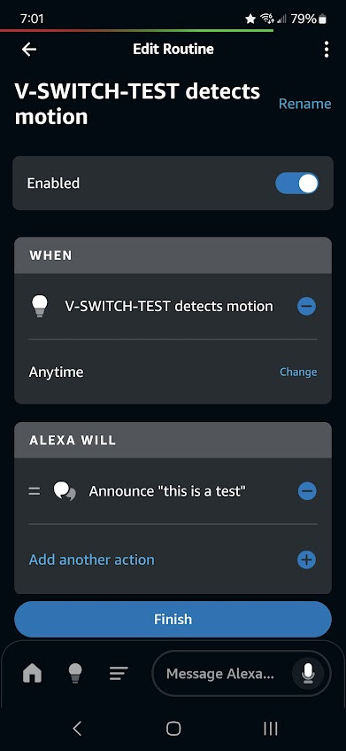

I use this ...
Create a v-switch using this driver.
add v-switch to Alexa [Amazon Echo Skill]
Then you can use it to say anything you want in Alexa.

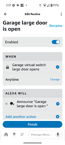

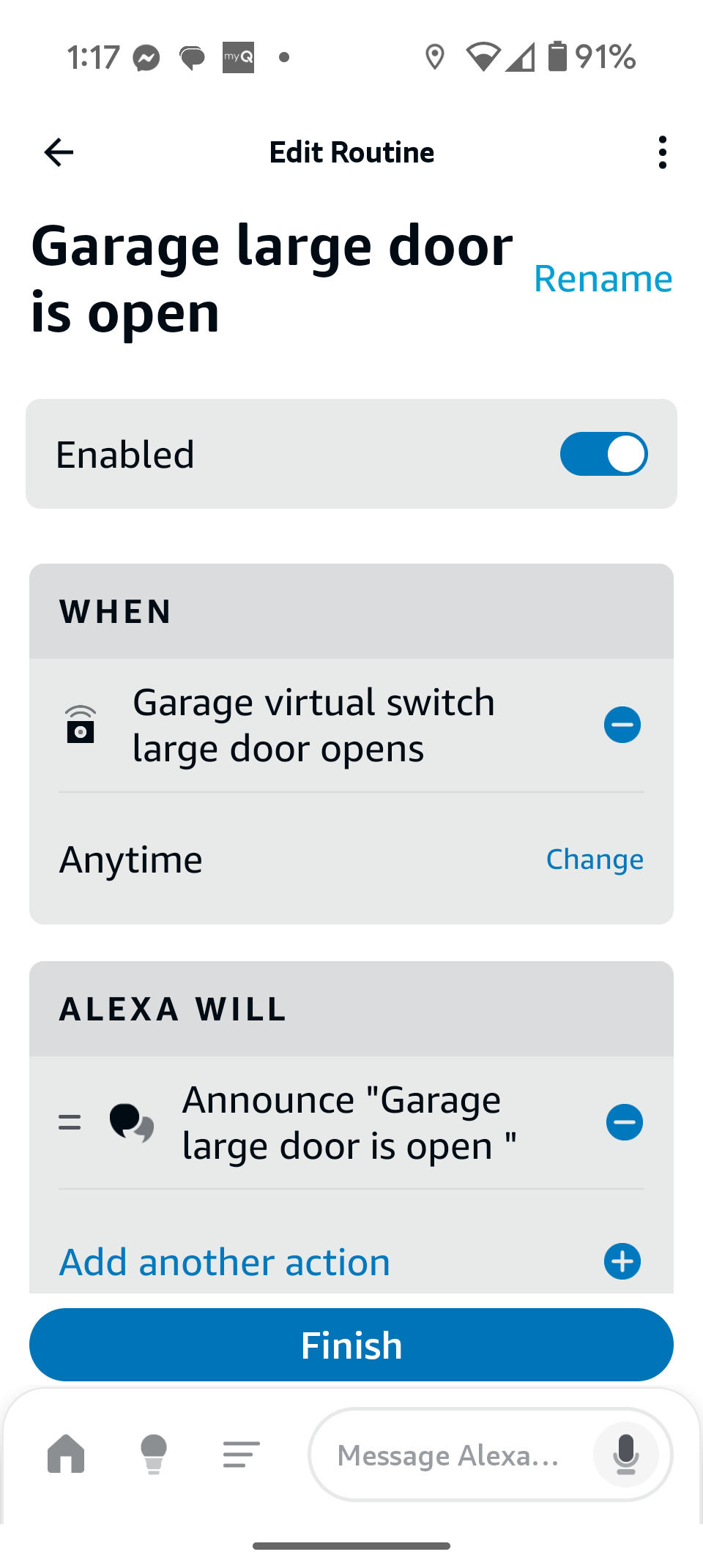

I use virtual contact sensors to trigger Alexa routines for announcements. Share the device with the Alexa Echo Skill. Played with Alexa speaks on and off but for a limited number of announcements this is easy and completely reliable.
