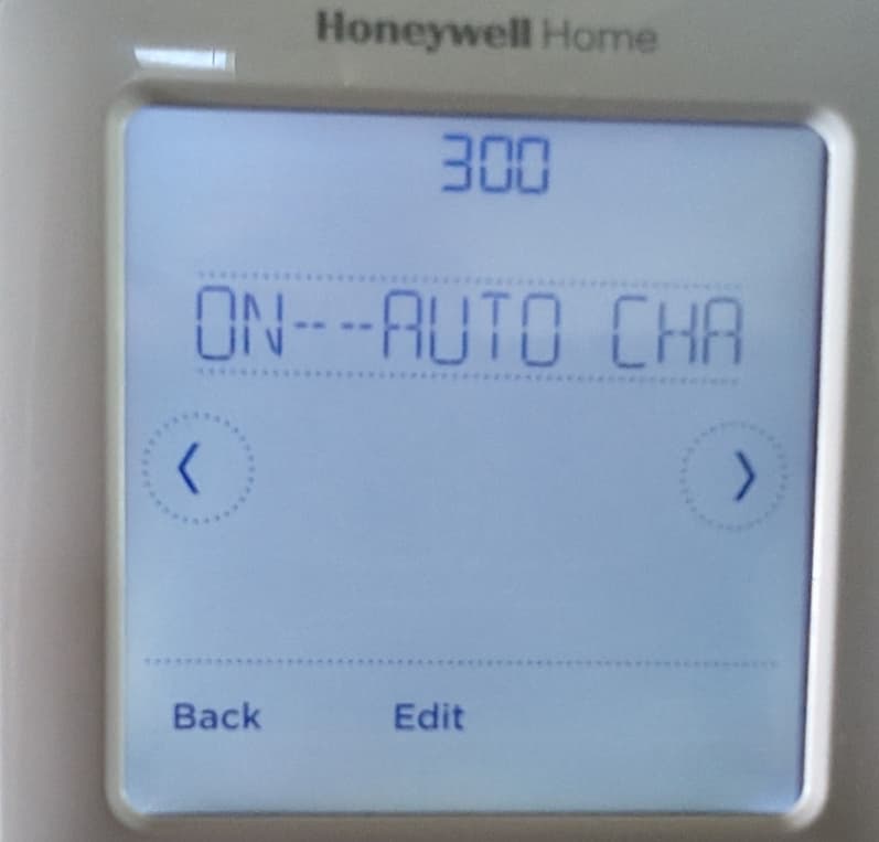

Use @thebearmay 's version, works fine with Auto. Just make sure that ISU 300 is on

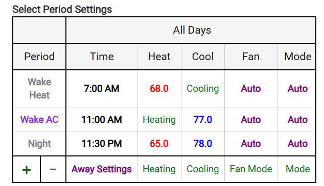

My original issue was not related to the generic drivers "Auto" mode and Alexa not working. Alexa was not working at all. It refused to be pushed to Alexa by the Hubitat. I deleted the thermostat and everything in use by it, reinstalled it, and Alexa voice commands worked fine. Then I set the "Set Thermostat Mode" to "Auto", and found that when I said "Alexa, set the downstairs thermostat to 77", I got the response "The thermostat is on auto". I changed the mode to "Cooling" and Alexa commands work as expected. Which leads to my next question.
To get Alexa to respond correctly I changed the setting Devices -> Downstairs Thermostat -> Set Thermostat Mode -> Cool. Below is a schedule that I created and as you can see all modes are set to "Auto" So would this scheduled "Auto" setting override the "Cool" setting in the device settings?
It likely will as that will be a new command. Now if you want to disable auto (and being overridden) you could set ISU 300 to off on the T6

ISU 300 is referring to that specific parameter setting within the T6 itself (it has nothing at all to do with Hubitat) -- refer to your T6 manual for more info.

No that is in the setup of the T6. Press and hold MENU to get into setup. The ISU number will be at the top... Just keep hitting the right arrow on the screen till you get to 300. Also if you have a multistage system, you can change that setting as well in the ISU's (forgot what ISU it is)
Do you mean this screen:
Also, still not sure how to install the driver. I see some code text files, then I think I use Settings -> Restore Apps. What file should be installed?
yes
