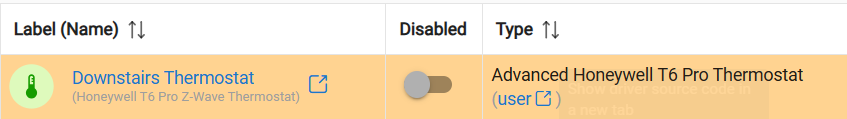

Thanks. I installed the advanced driver yet when say "Alexa, set the downstairs thermostat to 77" I get the response "It's set to auto". Which is the same behavior as the generic driver.
I thought Alexa and Auto mode worked together with this driver?

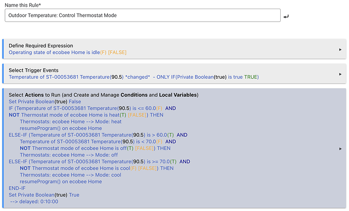

Obviously, the needs of your home could very well differ from mine. But I don't set my thermostat on "Auto". I use automations to set it on Cooling mode, Heating mode, or Off. The automations are based on the outdoor temperature, which I get from a Tempest weather-station in my backyard. Here is what the automation looks like:
Basically:
  • When the temperature is <= 60F, the thermostat is set to Heat mode.
  • When the temperature is >= 70F, the thermostat is set to Cool mode.
  • When the temperature is between 60-70F, the thermostat is turned Off.
Very simple, but seems to work quite well.
