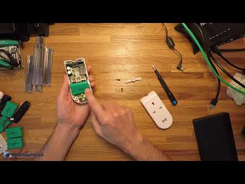

Motion Sensor
The Motion Sensor is automatically recognised and works perfectly. To reset and pair:
- Remove the battery if present and wait for at least 10 seconds.
- Locate the 'tamper' button.
a. On v1 sensors it is in the upper-right corner.
b. On v2 sensors it is in the middle of the circuit board. - Insert the battery and immediately begin pressing the 'Away' button, once per second.
- When the green LED in the corner begins double-flashing, the device is in pairing mode.
