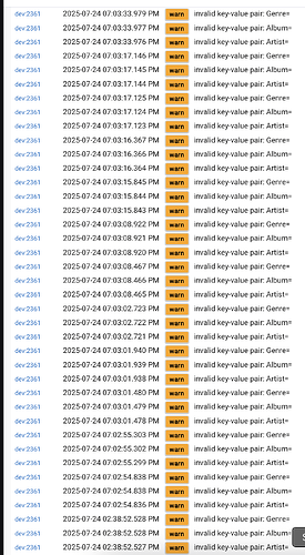

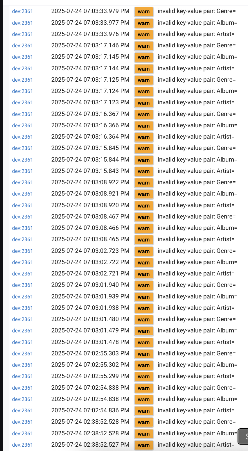

Four times I've come to the HomePod mini blasting out a classical station at 100% volume. When I've left the house each time, no music was playing. I use the HomePod mini for TTS. I'm kinda depending on it now.

Of course, there's nothing in the logs, so I got the bright idea of looking at the Roku cams. I don't have sound event detection enabled, but the poor cat was wandering around about 3 hours after I left the house, with the music blaring. I arrived an hour later.
I'll turn on sound detection and see if it happens again on .129.
I'll probably turn down the sound volume on my TTS notifications so if (when) it does happen again, perhaps the cat won't get bombarded by all those decibels.
