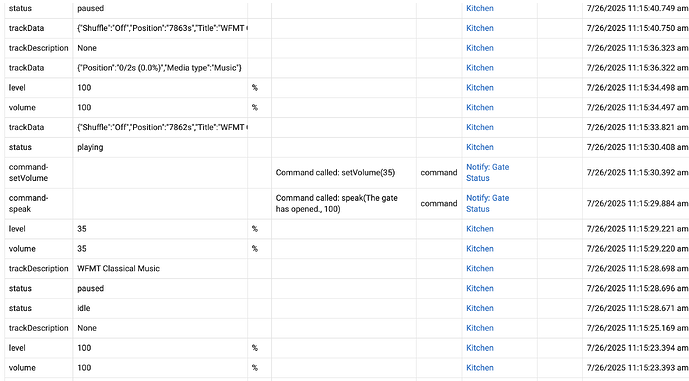

I play a free station from Apple, so that probably why I get those errors.
The HomePod seems to forget what station I've been playing after some period of time, several hours.
During this period, I get two sets of errors, probably related to restarting the previous program before the TTS announcement broke in.
After this period of time, I get no errors.
The errors don't bother me as long as it works right.

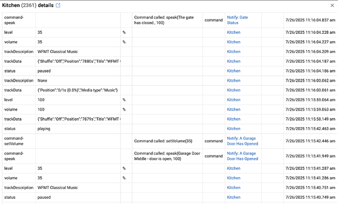

Well, the problem came back on .134.
I went out for a couple of hours, and when I came back the classical music station, the last station I had listened to, was playing. Thankfully only at 35% because of the rule changes I made.
I'll paste a copy of the events below, without repairing the Ecobee stats.
