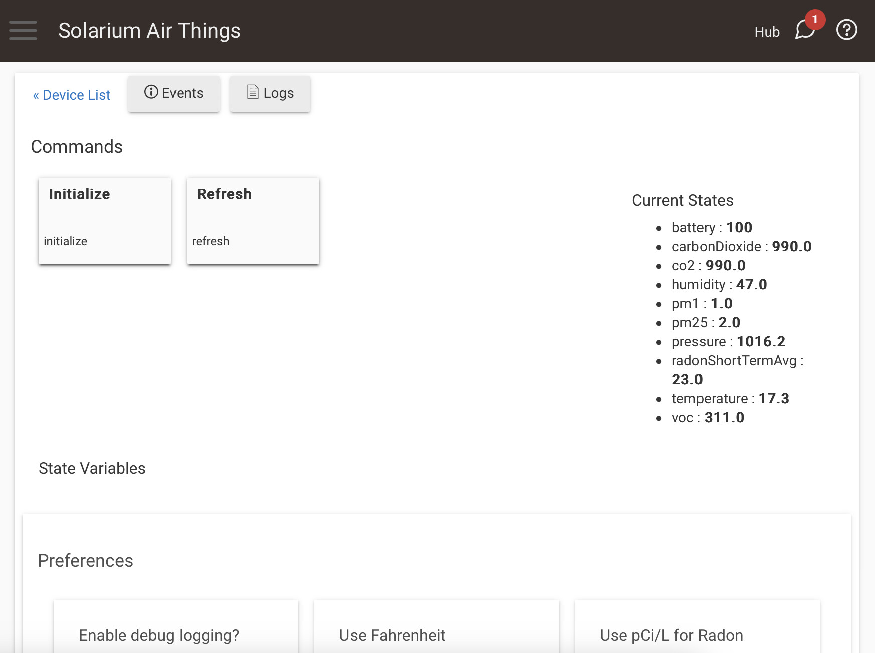

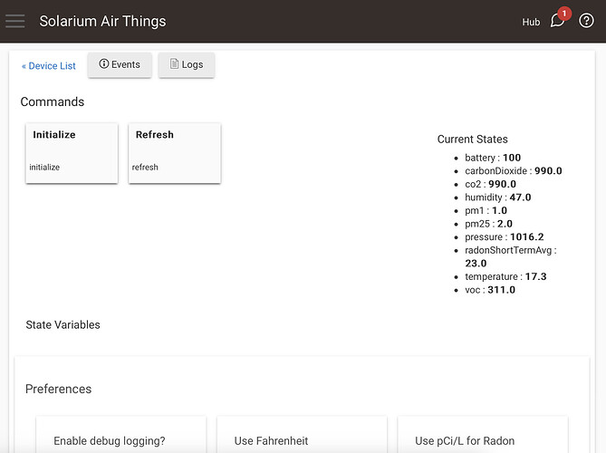

Thanks for the update but somethings not quite right. The returned value is 2195.36292714217461252701468765735626220703125 but the actual real AH for the current values is 7.63 [g/m³].
Looks like I missed the divisor. When you get a chance can you pull it back down and give it another try?
Unfortunately it's now showing zero (0) as the value.
May not have liked the way I rounded, can you try again?
