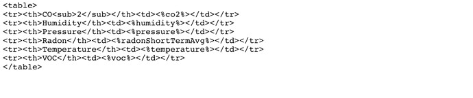

Under preferences there is one labeled Template for generating HTML for dashboard tile. There should be a corresponding file in File Manager using that entry as it’s name (no spaces or special characters). There is a template file you could use at https://raw.githubusercontent.com/thebearmay/hubitat/main/airthings/tileTemplate.txt

Hmmm try putting a copy of the template on Hub 2
The AirThings Device doesn’t create a separate device, that device is from an instance of the Tile Template Manager app which creates it because it can’t create an attribute in the regular device.

Should be creating an html attribute in the device. Is your dashboard using one generated from the Tile Template Manager? (Same code base and the templates from AirThings would work in it.)
Ah! It wasn’t creating an html attribute as far as I could see…. But removing the link fixes the issue - error no longer appearing in the logs.
I added it again to see - the error comes up, but the attribute doesn’t. Probably because of the error…? :blush:
Yea, the error is keeping it from creating it. Wonder if it is getting locked out by the other instance.
