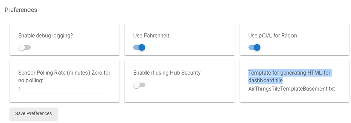

To use the custom tile template feature just copy the template text below and save in a .txt file on your computer. Customize the names and values for your liking. Then use the File Manager feature in the Hubitat Settings page. Click the "+Chose" button and go to the location where you saved your template and select it. Now select the "Upload" button to add your template file to the Hubitat File System.
Now go back into your AirThings Device and enter the file name you uploaded to the Hubitat File System as the value for "Template for generating HTML for dashboard tile" in the Device Preference Sections.

@swade Sorry to bother you, but I do "need additional assistance..."
Followed your steps exactly, but now that I have entered the file name for the template as you directed above, what are the next steps to get that tile on a dashboard?
  • It does not show up in the template dropdown when adding a tile to a dashboard
  • I thought it might be a virtual device, but not really sure how I would set it up if it is...
Once you’ve given the air things device the template path, it should generate an html attribute for use with the Dashboard Attribute Tile Template.
Did you add your AirThings device to devices allowed on your dashboard. Look under Apps for the dashboard section and then add your device. Then follow what thebearmay says above my message.
@swade : Yep. Did that in step 20 above
@thebearmay : AHH. I get it now. I was looking for the *txt file in the "Pick a Template" dropdown.
Instead, I did as you directed and in "Pick a Template" selected "Attribute" from the dropdown
Then, in "Pick an Attribute" selected "html" from the dropdown.
Works!

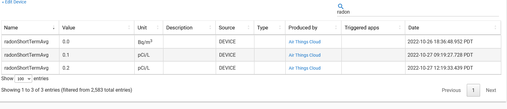

in the device page, the radon IS selected for pCi/L , but in the HTML text the units are Bq/m3.
Am I missing something? or is the text Bq/m3 hard coded? (the 3 is superscripted).
I am using the USB power supply also, so it is also a hub.
I gather the data is coming from the airthings servers and not locally? so if I turn off polling, the data will not update?
Thanks guys for this!
The default is Bq/m3 and the first reading the device gets will more than likely occur before you set the switch to pCi/L -> should switch on the next reading after the switch is flipped.
Don't know when it changed, but it is now pCi/l, both in the device and on the dashboard!
Maybe took some time because the device is still in it's calibration mode (7 days), so things are slow right now.
Thank you!
I took a look at the events log for the device and it looks like the first reading with the pCi/L setting occurred about 14.5 hours later:
