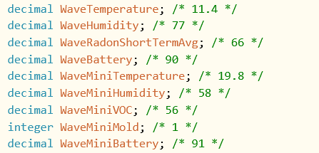

The reason why I'm asking is that previously, I've been using a webcore piston to poll the AirThings API, and the way the values are coming back from the API looks like this:
Despite the fact that I'm reading the values from the JSON directly into the variables and despite the fact that I'm using decimal variables, I'm never getting floats for VOC or radon or a couple of other values.
I'm not super familiar with groovy, but is it possible that groovy just appends a ".0" by itself?
You actually have to force a ".0" normally. What do the values look like on the device page?

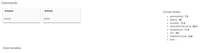

This is the device page for the AirThings Wave Radon:

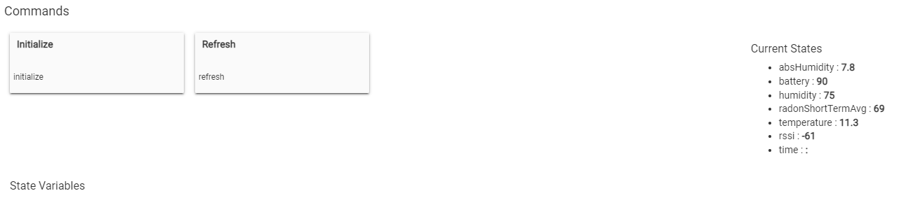

and here are the values for the AirThings Wave Mini:
Interesting the numbers are coming across formatted as decimal. I can add an option to force them to integer if you like. Give me about 15 minutes.
Should be out there now.
This is absolutely beautiful!!!
