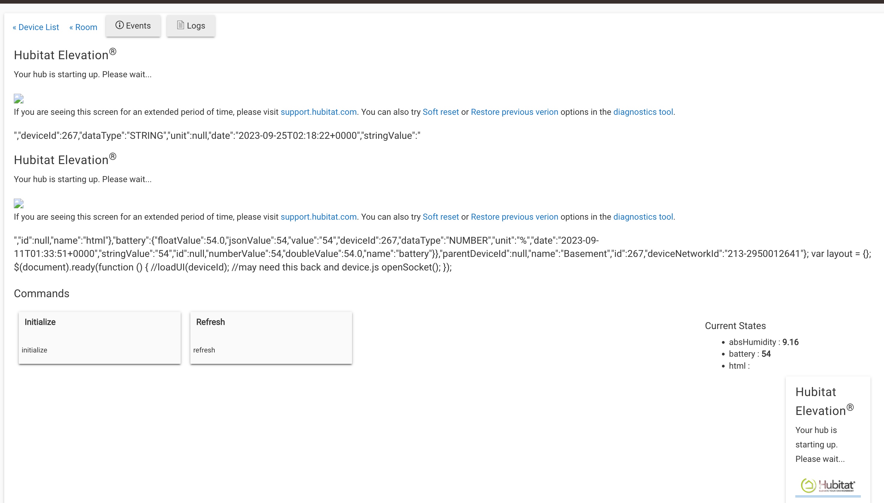

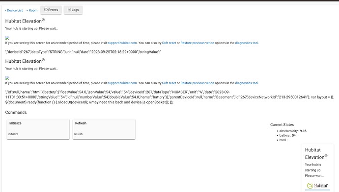

Second is both devices have a funky screen when viewing.
Thoughts?
The "funky screen" is due to the driver requesting data before the hub is fully up - should go away after the next poll. As to the 404 and resulting NPE, what version of HE firmware are you running? If below 2.3.6.x update to the latest and see if that resolves the issue.
HE version is the latest (2.3.6.144)
The funky screen remains constant, never goes away.
Do you have a valid template file listed in your preferences? If so, can you click update on the preferences and then Refresh
Candidly, I'm not sure what that setting does or how to use it correctly so I left the default of "--No Selection--". What should it be?
copy https://raw.githubusercontent.com/thebearmay/hubitat/main/airthings/tileTemplate.txt to the File Manager and set that option to it.
That did the trick re the funky screen!! Thank you!
