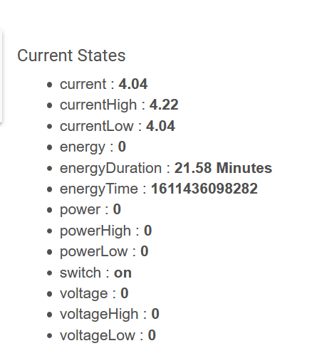

I just installed one of these to monitor ice melting cables. I only see current reported, not power or voltage (as in image attached). Doesn't seem right. Do others see power and voltage reported?

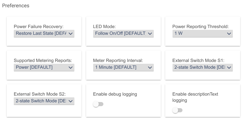

Did you:
Select this driver image
and then click image
and then set
according to your desires and click image
and then clickimage
? If so you should haveimage
@LosinIt Yes, definitely did all that. Several times. Always reads zeros for voltage and power. Only thing I didn't try so far was to chose a different driver, then switch back to the Aeotec nano switch driver. Can't figure it out. HE 2.2.4.158, C-5 hub
Can't hurt. Give it a shot.
I have a C-5 with 2.2.3.135
Might be a bad Nano as it's not showing any voltage though clearly it has power. Other things to check are the firmware version and your wiring.

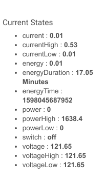

I have v2.1 on my switches.
