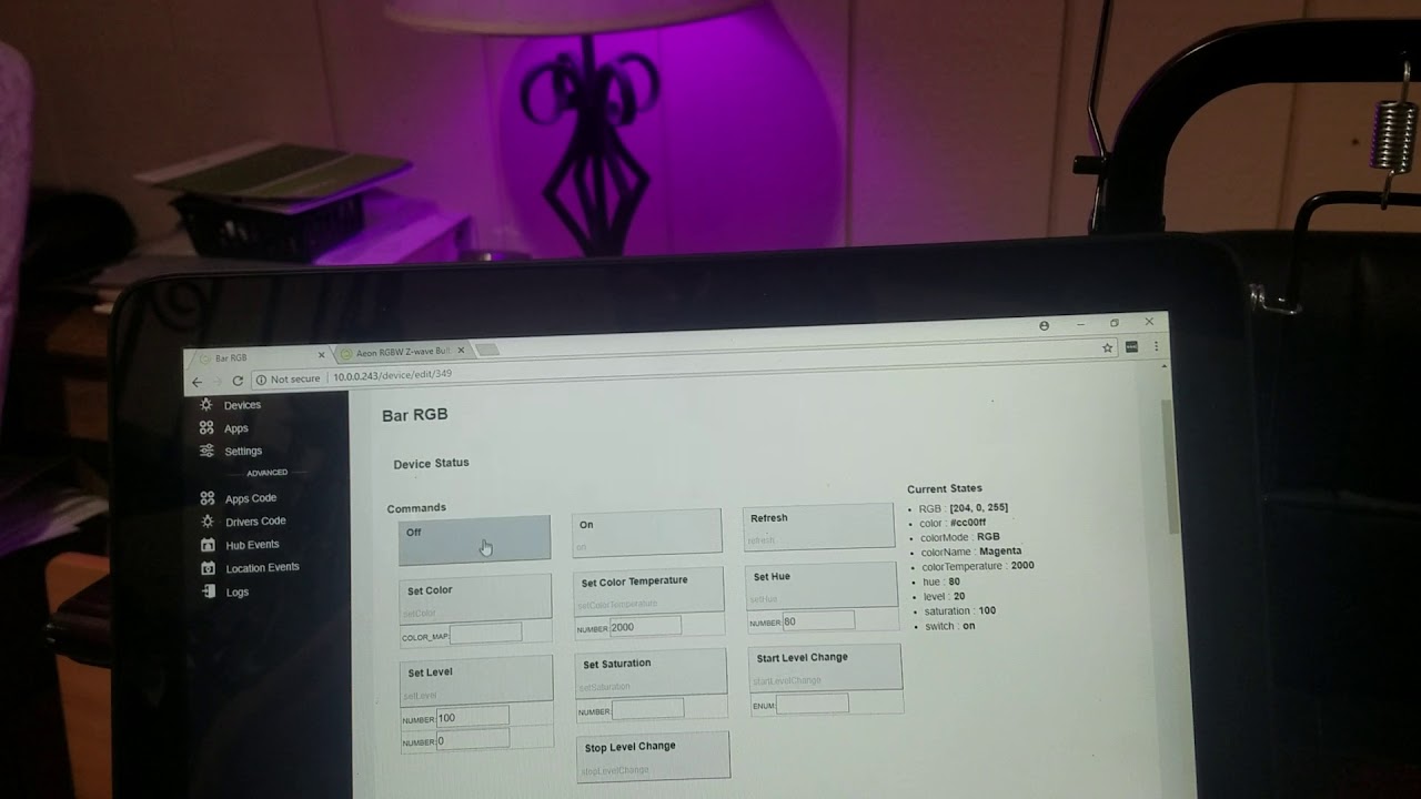

I can change color temperature, but it doesn't retain color when I do. If I set my Hue to 50 (Cyan @ 100 Saturation) and I set color temp to anything the brightness of the bulb changes and the color changes to white immediately. It looks like the lower limit is 2000 and the upper level is 7000.
Yes, but I found that if you change the level and then turn the bulb off before the driver receives/refreshes the new level (shown in Current States in the driver) then when it turns back on it goes to the last state that it did actually save.
So, setLevel and call Refresh then wait a few seconds (my level in Current States changed within 10 seconds), I could then send Off and then back On and it returned to the level that I wanted.
