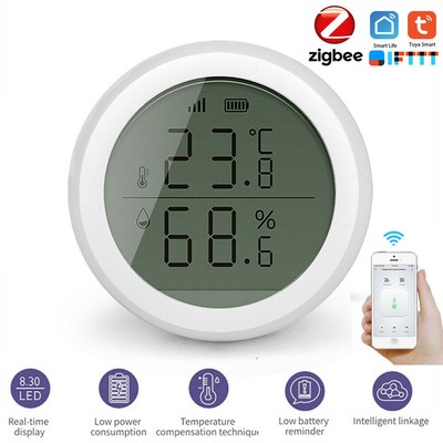

I found some cheap Tuya Zigbee humidity and temperature sensors on ebay that work well. For some reason the built-in generic zigbee drivers don't work (they detect the device but reporting doesn't work), but I was able to hack the Hubitat sample Zigbee drivers in github with a one or two line modification and have the little device reporting correctly. I'd be happy to share if interested.
If interested, here's the same one I got. I got it because of the LCD. Note: temperature is always in Celsius, but Hubitat can magically show Fahrenheit within dashboards/in the UI.
Those are darn cute...too bad they can't report in F on their screen, I'd probably get a couple of them.
I've learned how to do C to F conversion on the fly in my head (ok, it takes me 5 seconds to do the math). They apparently also have a newer version with no display at all, but I haven't tried them.
