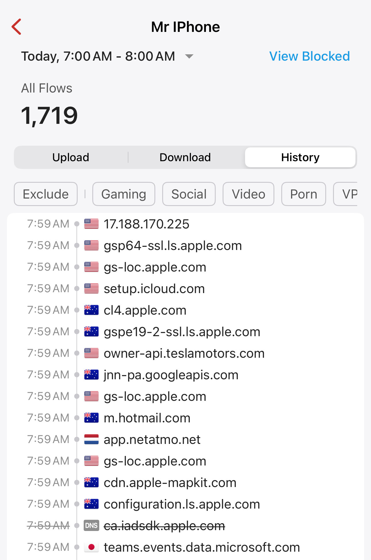

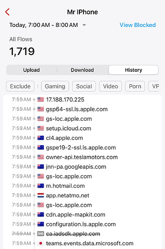

My thesis is that any device that the firewalla unit gives dhcp lease and therefore can see its LAN/WAN traffic it already reports online/offline status based on traffic and ip pings etc can already alert if device is online or offline. I just have to work with the firewalla devs (they are very responsive) and hopefully get a new feature added to allow to send a post to a url per device that is monitored.
E.g doesn’t matter if Android or iPhone as firewalla can see all the traffic’s of devices on the networks it manages and all phone are constantly chatty thus making its evaluation of if the device is actually online or offline more accurate. Once a state change the firewalla would theoretically send a post to makerapi defined url which would intern update the virtual presence device to the appropriate status.
