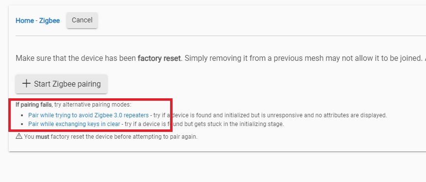

Is this a C8 or which hub?
If it is a C8, did you try the alternative pairing methods? I don't think the guided tests give you this option, so you would have to "manually" add by clicking Zigbee button instead of Brand or Device Type.

I am using the manual Zigbee pairing button in the app (also tried via Web interface as well)
