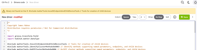

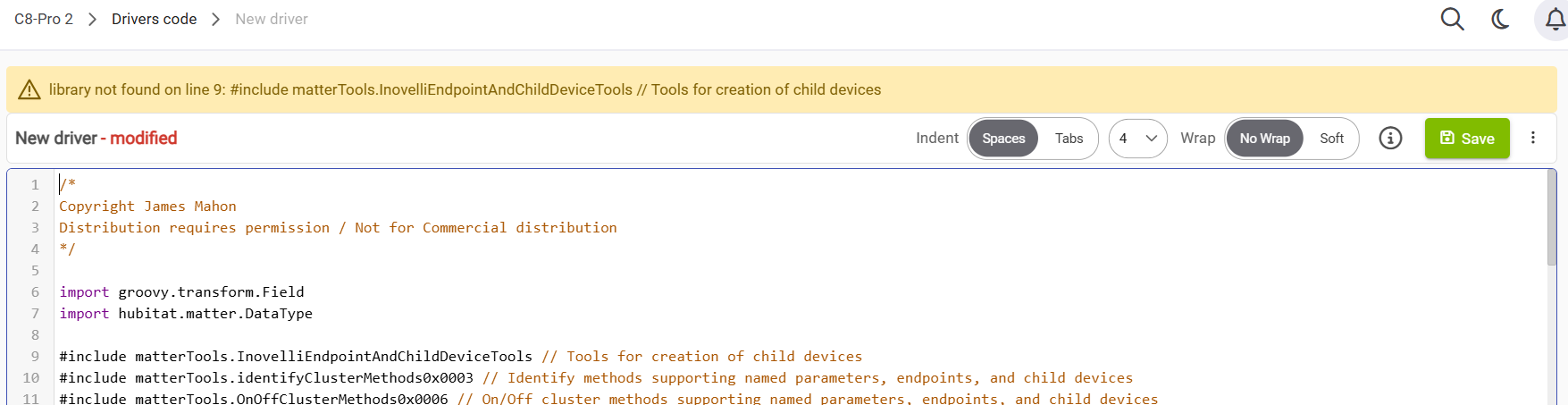

I get an immediate error w/line 9 when I try to save the driver...on C8-Pro and C8-Pro Thread, both on current beta (2.5.3.104):
According to AI, I needed to install all the libraries found here: Hubitat-matterTools/Inovelli at main · jvmahon/Hubitat-matterTools · GitHub I've already done that, so those errors are resolved, and now its endlessly trying to save it.
