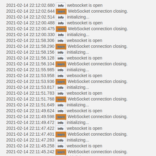

It is strange that every two seconds you receive a webSocket status update of 'closing'...
Ethernet. I change the driver, hit initialize and this start. This does not happen with version 16.
I think I understand what is happening... I am seeing the same thing if I click INITIALIZE. This is because doing so, causes the connection to be closed (even though it is open and working)... thus creating a loop.... I am going to dive in deeper to see if I can come up with a solution...(but I am all ears if any of your have any ideas... :wink: )

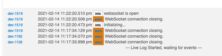

Will do. Rebooting the HE hub right now, as the prior version made my hub UI slow down significantly and that's not something I've experienced for a very long time.
It did the initializing twice but it's working fine.

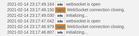

Screenshot_20210214_231930
Looking good so far here too. First three are when I was rebooting the hub.

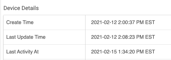

Screen Shot 2021-02-15 at 1.49.28 PM Screen Shot 2021-02-15 at 1.50.13 PM
Over 34 hours later and the websocket had not closed once. I did however try intentionally restarting the HA service just now , and that does close the websocket, but it doesn't automatically reopen.
