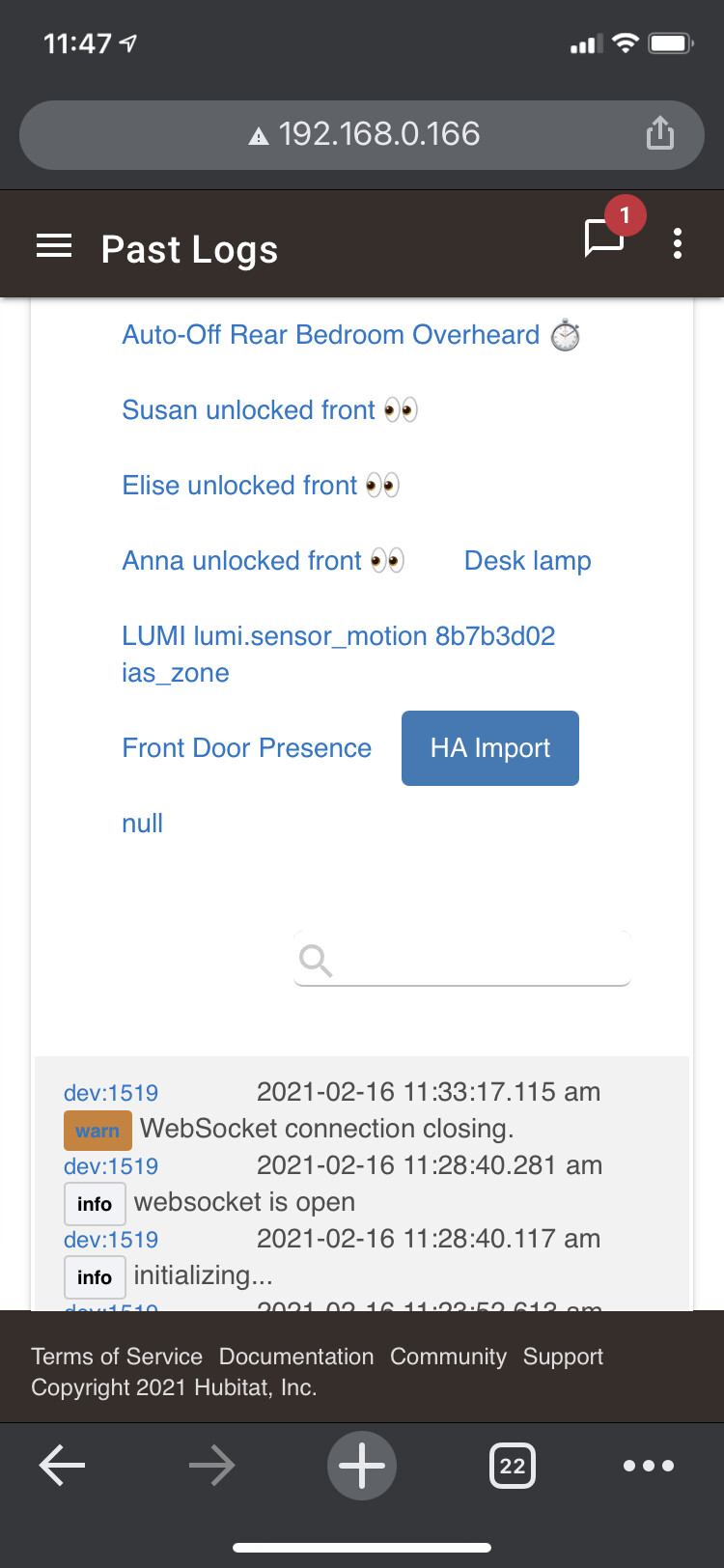

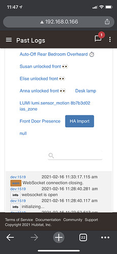

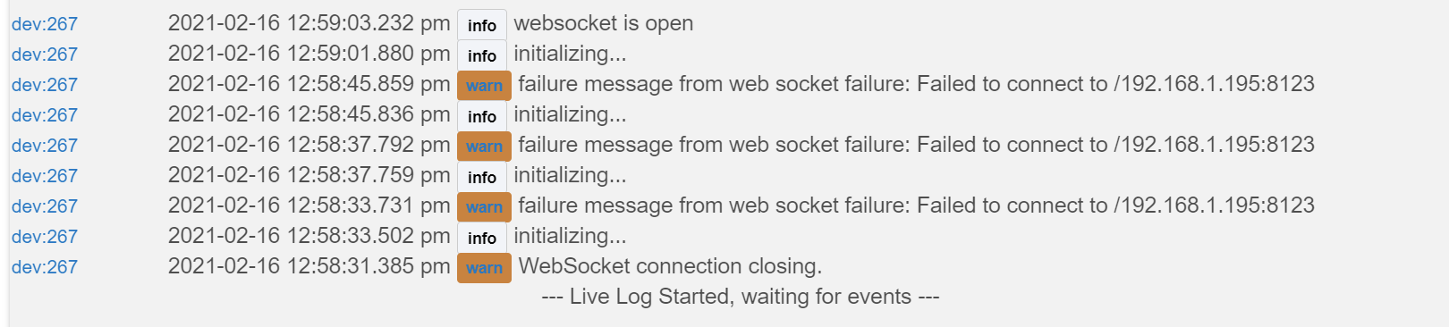

Unfortunately it’s not opening. You can see the time of the screenshot at the top left is 11:47pm and the websocket closed at 11:33pm

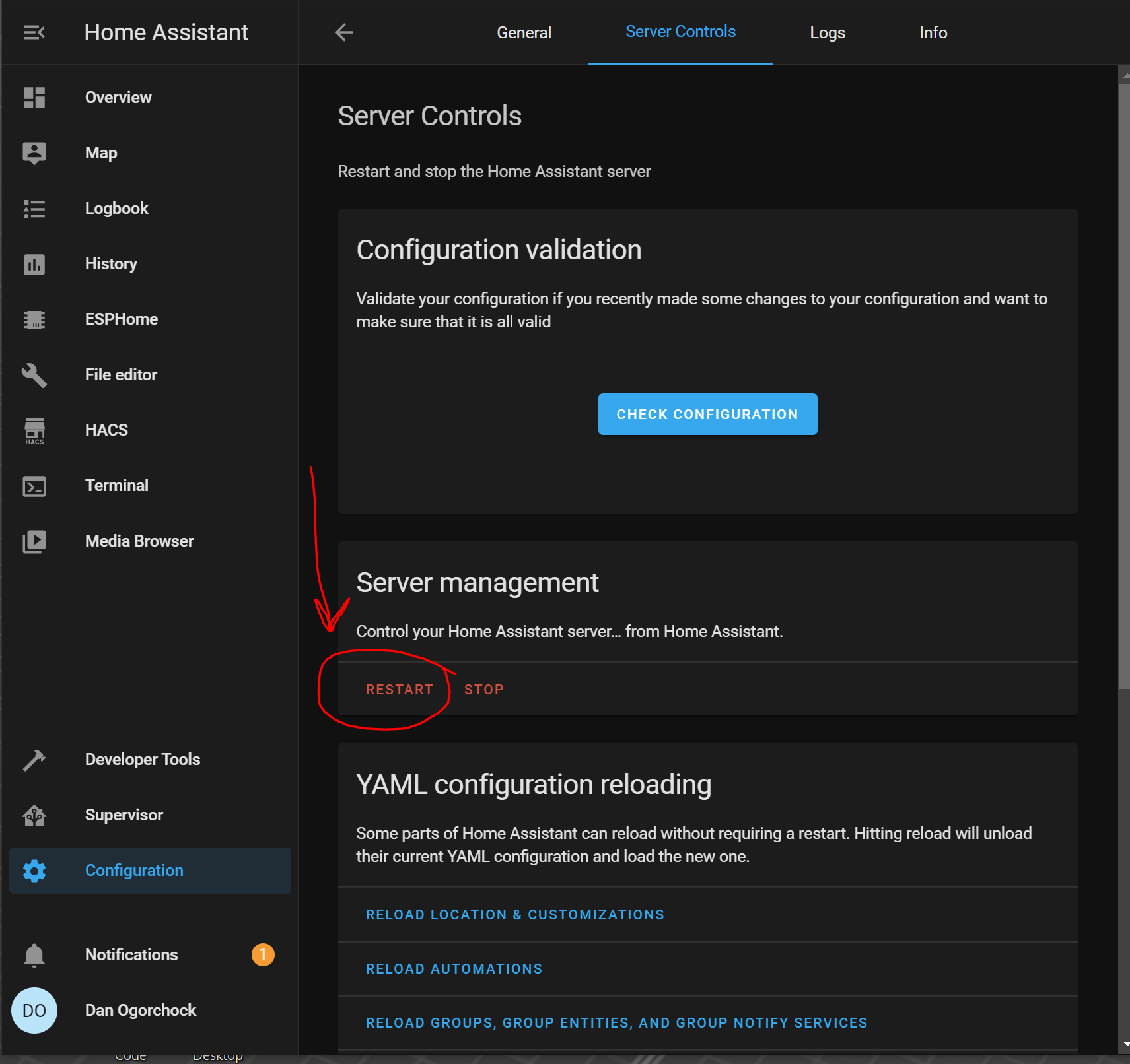

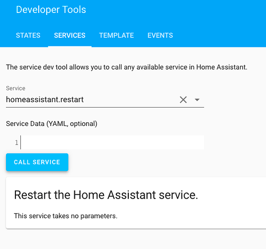

When you say you restarted the HA service do you mean restart HA? I did that and my system reconnected immediately.
I do it this way. Only restarting the HA service, not the virtual machine.
I did it this way. Which should be the same.

Strange... If I restart using the following method, everything reconnects fine...
reconnection...

That is exactly what I did and it does not reconnect. Strangely I never get those failure warning like yours in my logs

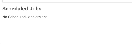

@SmartHomePrimer, when it is failing to reconnect, do you see the reconnection method scheduled on your device page in HE?
I believe this is done automagically behind the scenes via the Hubitat webSocket API... I know I have seen ping/pong messages appear in my log from my Harmonu hub driver....
No

I just stop my HA and nothing is scheduled in my device page
