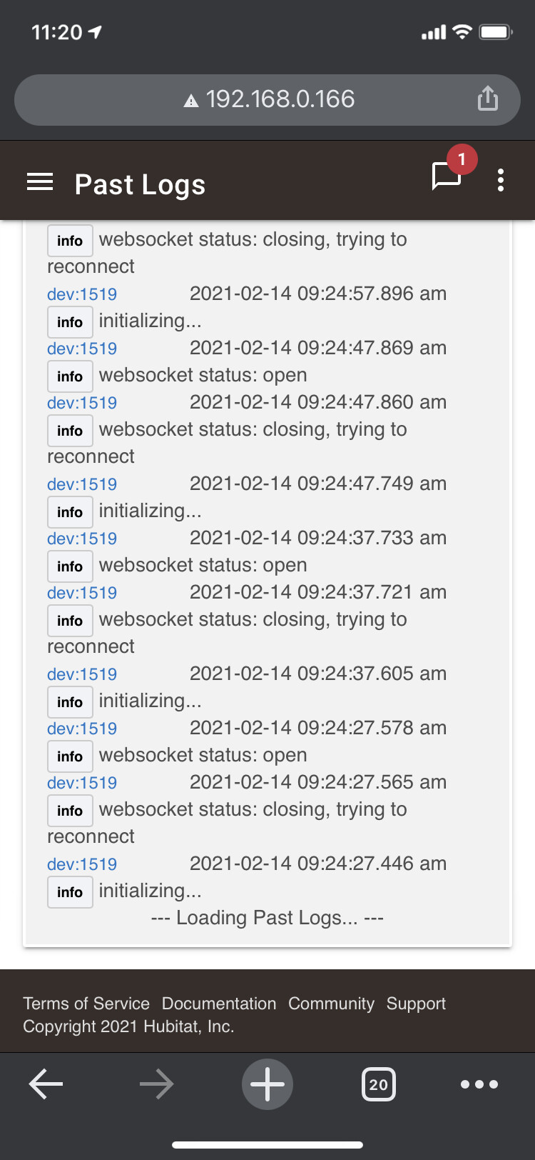

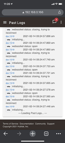

I had disable the debug logs (habit). It’s closing and reconnecting a lot.
I turned the logs on again and I’ll monitor for errors.
That seems like a lot. I suspect something is failing unexpectedly on the HA side, like @ymerj was discussing from earlier in his testing.

I installed version 0.1.15 and the initializing went into a loop. I put back 0.1.11 and it is fine.
That may be what @SmartHomePrimer was running into, @ymerj. I reverted my changes (made 0.1.16 version to avoid confusion), pending further investigation.
Ok. Left it at 0.1.15 and finally got an error
Removed the image because I’m a dummy and posted an error from another device
Although, it sure does keep that websocket open!
