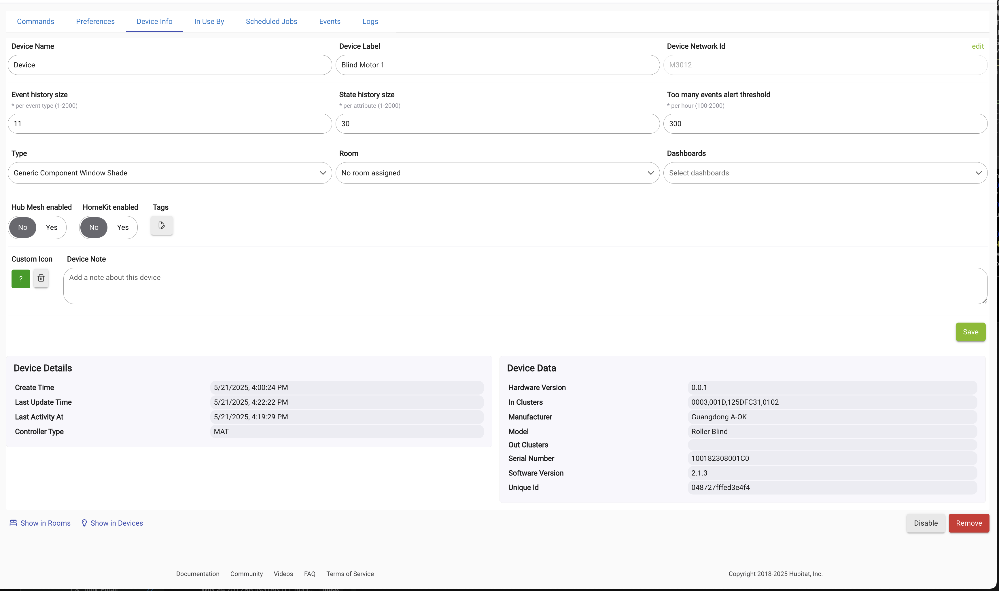

It imported without a device type so changed it to be Generic Component Window Shade. However, none of the commands seem to work. I also tried dimmer and generic zigbee window to no success.
This seem like a really nice unit, I would love to be able to control it with hubitat. Any Ideas on things to try.

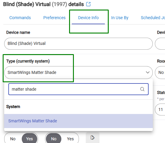

Try the HE inbuilt ‘SmartWings Matter Shade’ driver :
Thank you Krassimir! That did the trick. Open and close working now,
The set absolute position doesn't seem to work and I don't seem to get battery status, which were the two things I hoping for. Could they work with a different driver?
amazing, that got the absolute position working. now just looking for the battery. is that something that needs to be queried or is it pushed out regularly.
