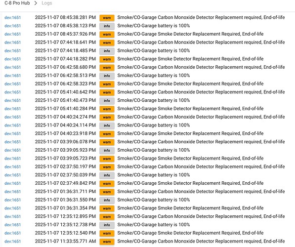

C8 Pro is now on 2.4.3.149
Now that its updated, all my First Alert (BRK Brands Inc) ZCombo-G Smoke/CO Alarm" are all now reporting (All 9 of them)
dev:15962025-11-06 10:59:55.346 AM warn Laundry Room Smoke/CO Carbon Monoxide Detector Replacement required, End-of-life
dev:15962025-11-06 10:59:55.152 AM info Laundry Room Smoke/CO battery is 94%
dev:15962025-11-06 10:59:54.970 AM warn Laundry Room Smoke/CO Smoke Detector Replacement Required, End-of-life
They are not at end of life, in fact one is less than a year old and the others are only 3 years and they are a 10 year device.

Me too on the ZCombo:
FYI, working with hubitat staff now and providing them the info they requested, hopefully fixed in next release
Cool. It's definitely a thing:
I've also got a whole slew of them that are 1-2 years old frequently dropping that error as well.
The Hubitat team should have a fix for the next release. For now just dissreguard the warn message.

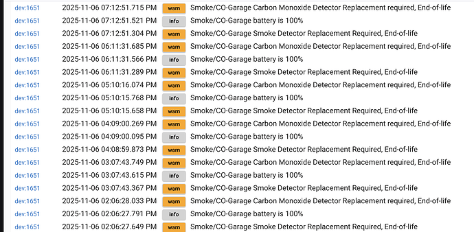

Was this warning on end-of-life ever fixed? I'm on 2.4.3.167 (and I am using ZWJS and want to try to stick with it), and I just noticed these warnings for all 5 of mine. They're supposed to be 10 year devices and were manufactured around 2022.
Bug is still there. But its only a notice in the log. Does not cause any issues.
Thanks. Still sent me into a bit of a panic when I found them. Luckily found this thread.
I just noticed this today (C8-Pro, 2.4.3.177, ZWJS). I was checking manufacturing dates, install dates, purchase dates, product manual.
Then I finally searched the exact warning phrase which brought me here. Now that I know it is a nuisance warning, I can calm down. Still not ideal, but not the same "putting loved ones at risk" panic that I was spiraling towards.
