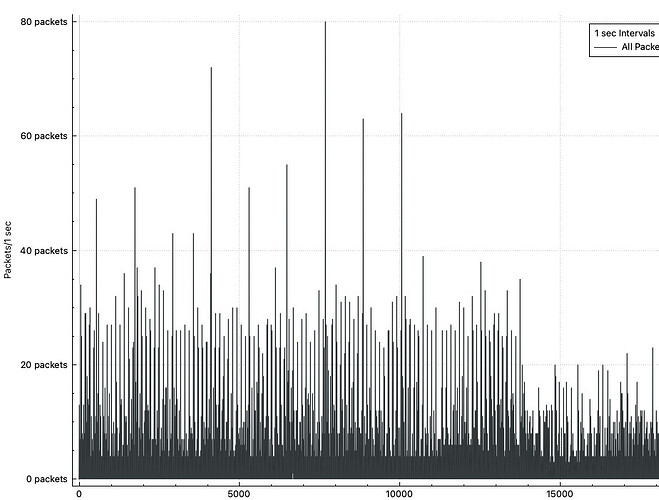

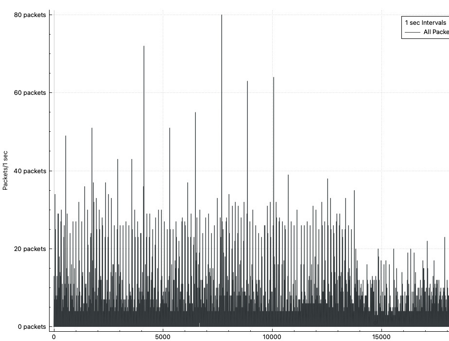

Ok, the iMac has been up for 77 days, but still... seems like a huge amount of traffic. So I fire up Wireshark to take a closer look at mDNS traffic:
The sudden drop in activity (around 14,000) corresponds to the moment where I shut down the C8 Pro (I can't really shut down the C7 during the day).
Running a capture shows that the two hubs are by far the most active on mDNS and the C8 Pro has twice the packet rate of the C7 (!).

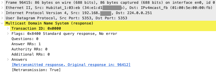

Looking at the packet stream, I see tons of "cache flush" messages coming from both hubs, many (most?) being "Retransmitted response":
Does any of this look normal? I'm a little out of my comfort zone with this mDNS stuff.
