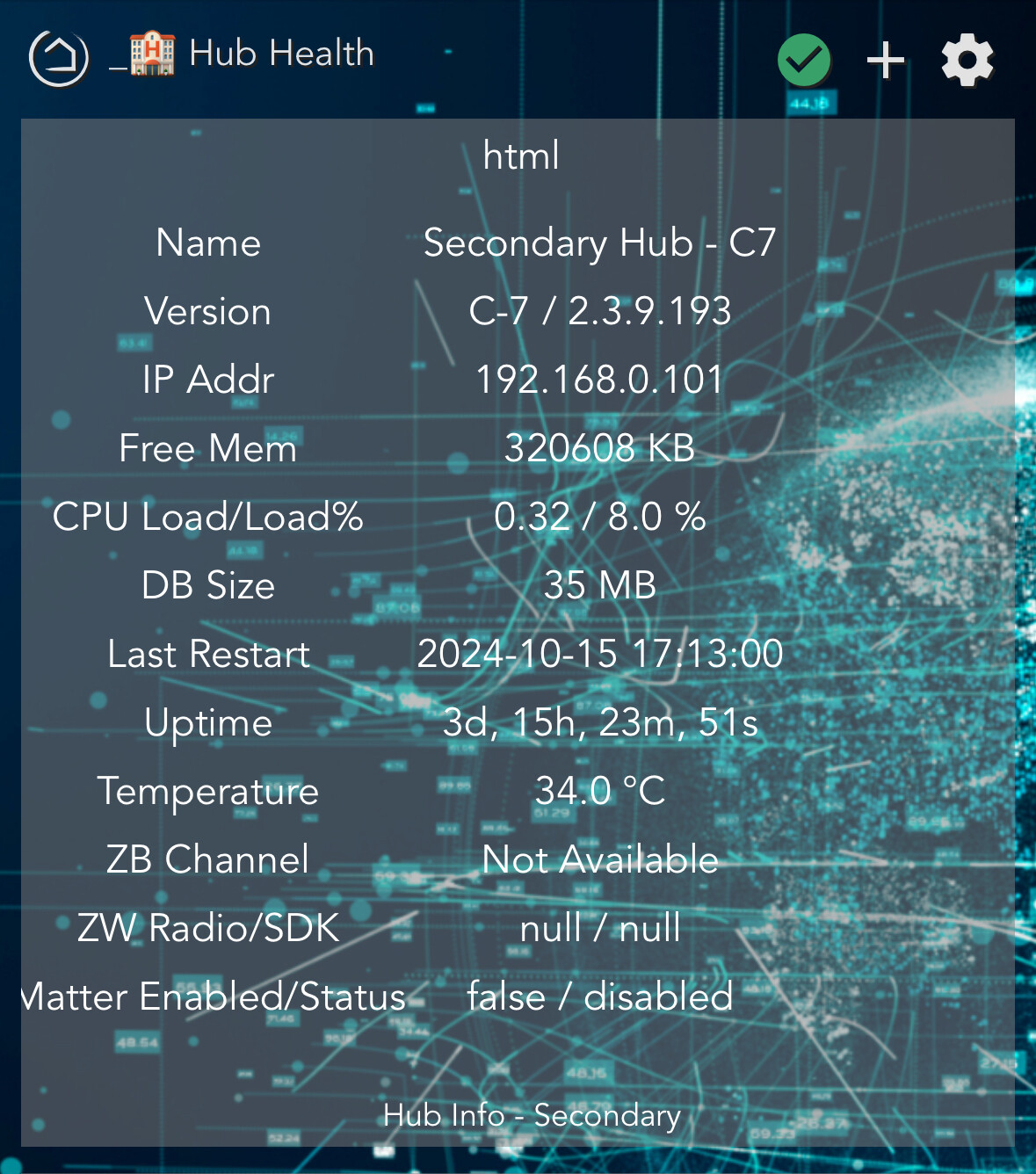

Is been over 3 days since I did this, and zero issues.
