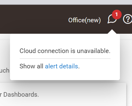

As noted in the thread Jeff linked, I witnessed all 4 of my Hubs reporting a "loss of cloud connection" this morning at oh-dark-thirty on my way out the door to work.
All four are on .193, and I have a C8Pro, 2 C8's and a C7 in operation.
I can't check on them remotely, or test if a reboot would work to resolve, but it struck me as odd this morning.... I've never seen this error previously, and all 4 of them getting the same error, made me believe that in this case, it was a cloud issue, not anything with my hubs.

I can confirm, a simple reboot of all 4 of my hubs eliminated the "Cloud Connection lost" notification.

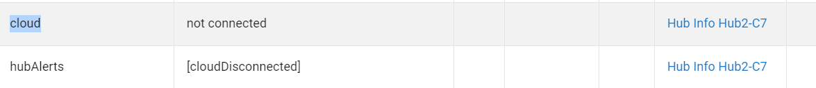

Add me in....C8 and C7 both having cloud disconnect. C8-Pro still connected. All are on latest, 2.3.9.193.
I'll send you the relevant Hub UIDs in case you want to look, @gopher.ny.
Another data point that may or may not be relavent - my hubs running Matter seem to fail more often that those that aren't. (Matter operation is unaffected.)
