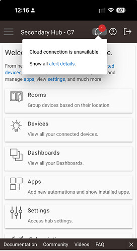

With my C5 hub I am now noticing Cloud Connection Disconnects extremely regularly, requiring restarts. Even with the Cloud Connection is unavailable notice, I have no issue pinging cloud.hubitat.com, but connection to cloud services like Amazon Echo Skill do not function until I restart.

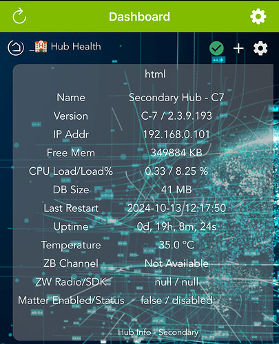

I’m getting this on my secondary c7 too. I seem to notice it happen the day after a reboot eg to update firmware. It’s been happening for a couple of months for me.
This is my hub that runs all my LAN and Cloud integrations, they all keep working normally, so this suggests it’s a Hubitat issue.

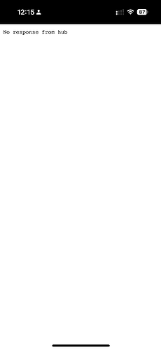

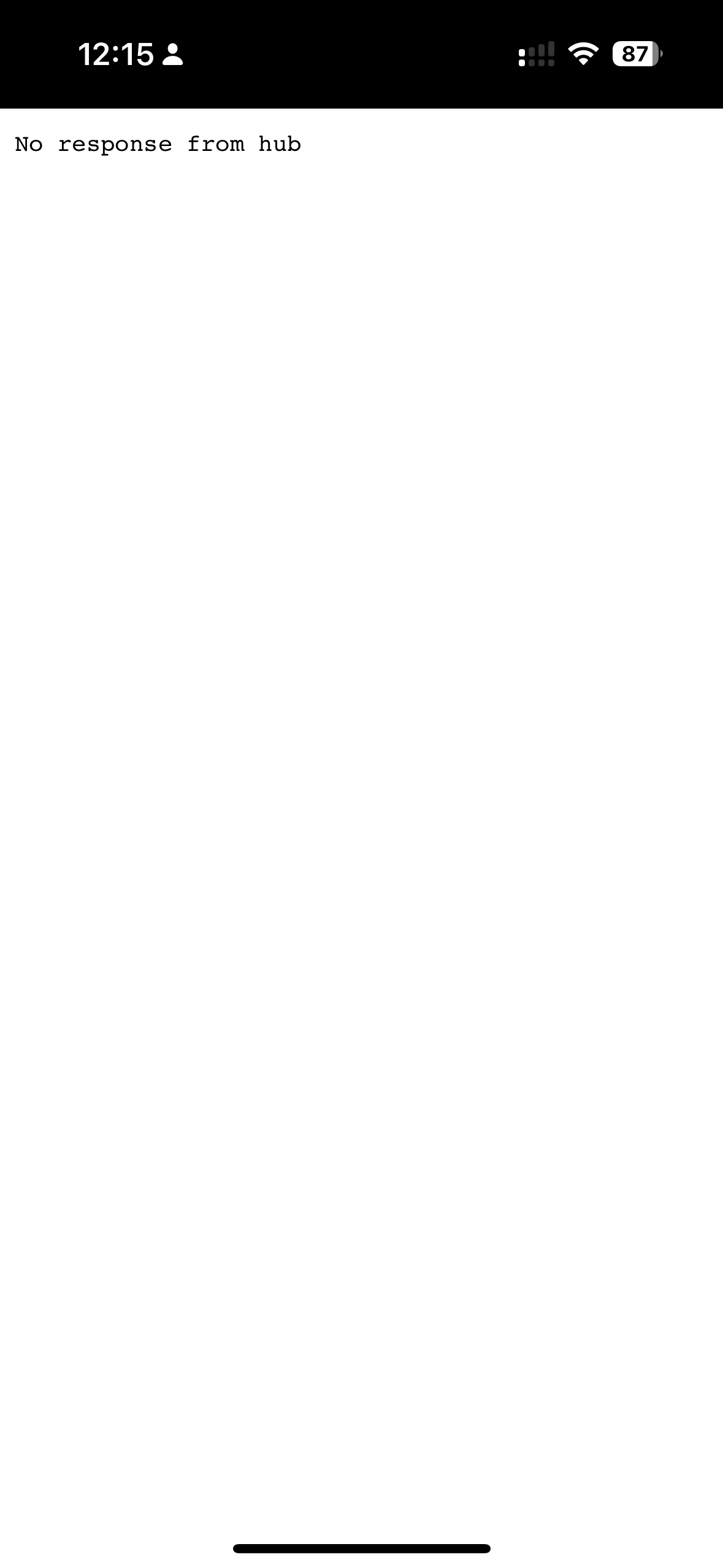

I usually notice it when I can’t reach my cloud dashboard links:
If I reboot the c7, it’s back to normal. My c8 pro hasn’t had this issue happen at all.

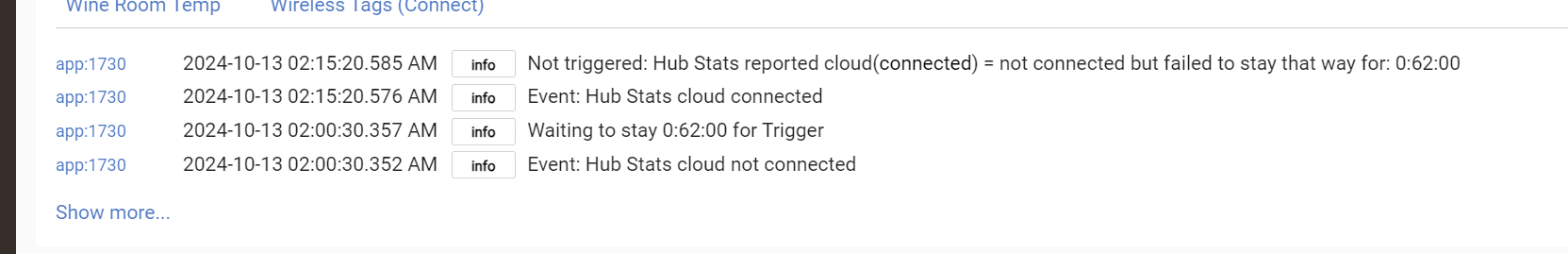

It’s done it again today, last reboot was yesterday after it happened. .193 is definitely worse than previous versions.

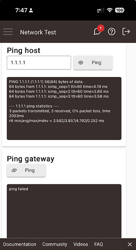

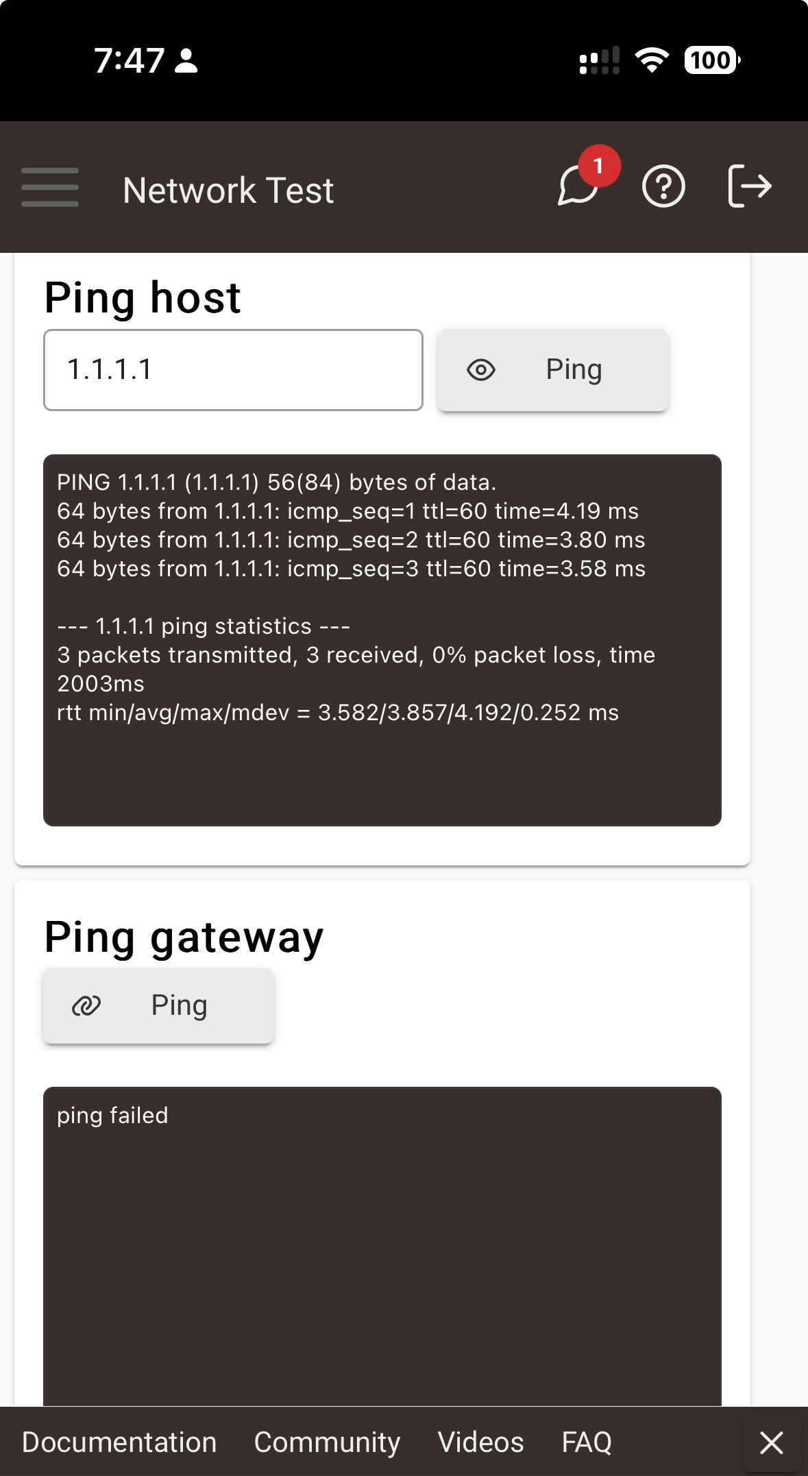

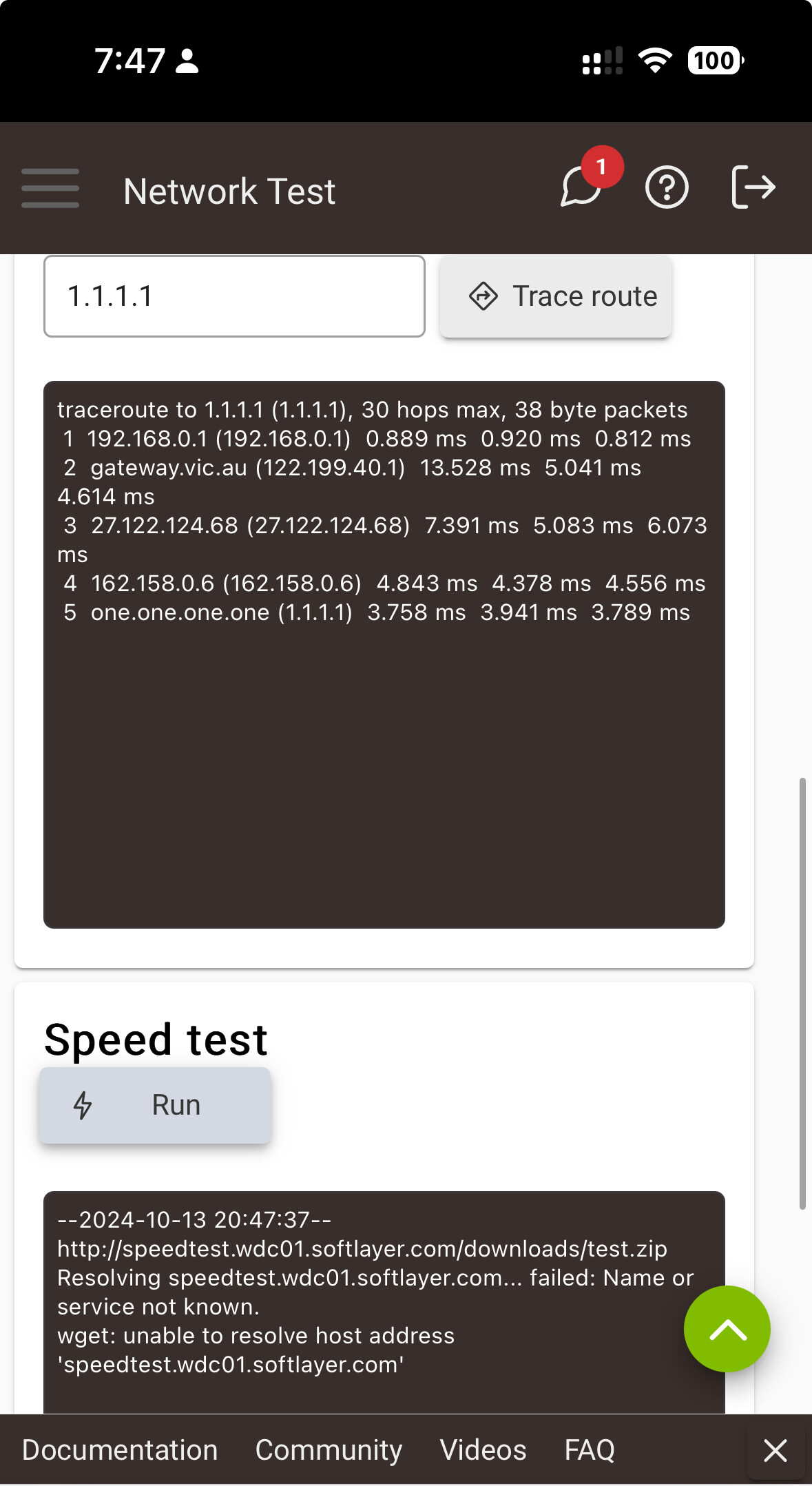

It looks like a DNS service failure..,
speed test never works anymore url is invalid.. weird it cannot ping the gateway what is your default g/w even if cloud is down your router should be up and you shoujld be able to ping the gw.
My gateway is just a normal .1 address.
Edit, that’s weird, even after a reboot, ping gateway still doesn’t work on my c7. It works perfectly on my c8p.
when it happens see if you can ping it by ip..
even when i loose cloud access my gw is still pingable as long as the router is up.. shouldnt need dns for that.
could you ever ping the g/w your router could be blocking pings to itself depending on config. i know in my case the auto restart of the cloud process is now working.. ie..
very weird.. firewall.. or are you sure that is the ip set.. i dont see anywhere it is shown in the hub interface? maybe it is not getting it from the dhcp server
sometimes i wish we would be trusted with shell access. just in this case to run ifconfig.. sigh
you could try temporarily setting a static ip and directly setting the g/w and see if that works.. but my feeling is the missing g/w or inability to ping is not related to your issue with cloud down..

fwiw I'm also getting Cloud disconnects here in Australia on my C7 hub with 2.3.9.193 after approx 4-6 hours. It doesn't matter if I use my DHCP provided DNS or if I use the "well known DNS services (8.8.8.8, 8.8.4.4, 1.1.1.1, 1.0.0.1, 9.9.9.9) as fallback DNS servers". The hub will reconnect if I reboot it but it disconnects again after approx 4-6 hours.
