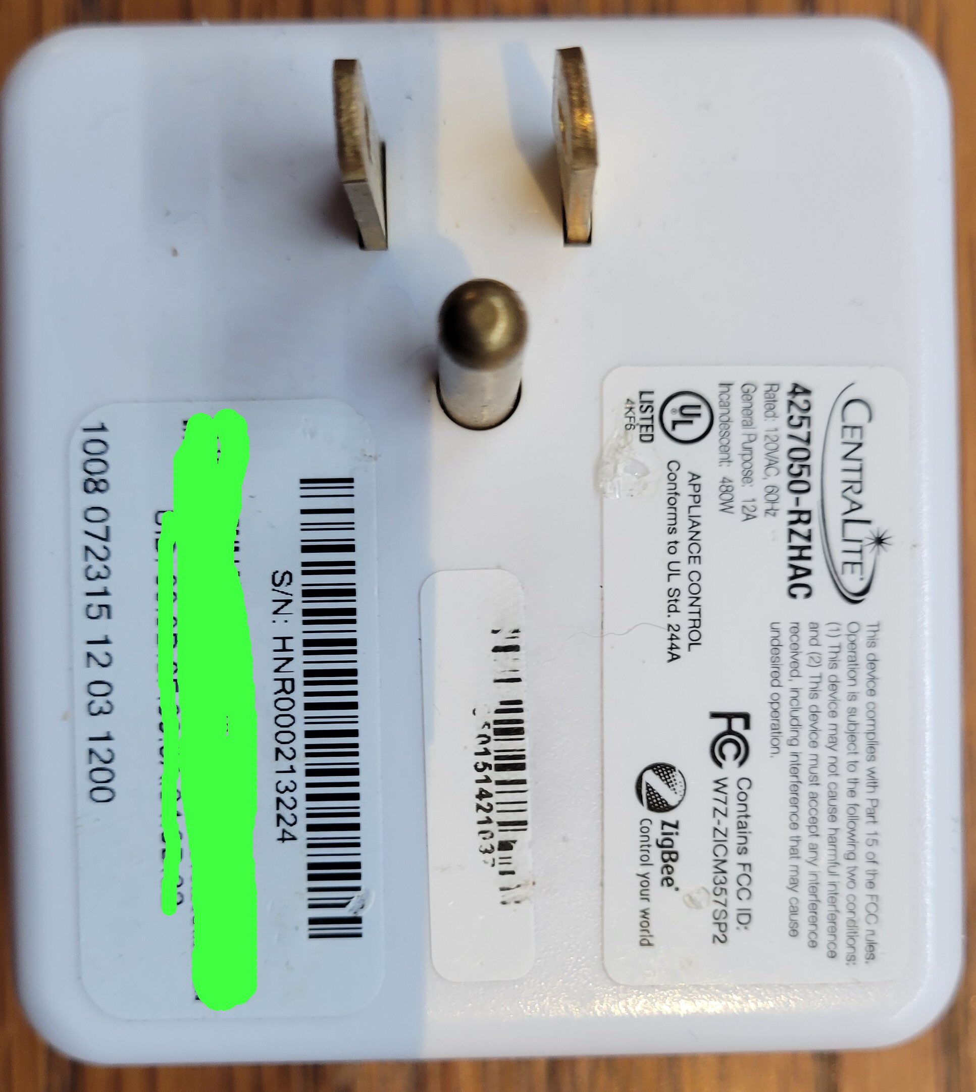

Boy do I feel like a dummy. I fired up a spare C5 hub and tried to pair and it wouldn't... Humm
The problem turns out to be operator error. I was plugging the outlet in while holding the button until the light flashes. As I just discovered I was supposed to plug it in while holding the button but releasing it as soon as the light came on. Jeez louise all this time screwing around with this thing. I guess I should write it down next time? Sorry folks
You're not the first to fall down this path, so don't worry too much about it. So many devices, so many different reset/pairing steps. It would have been nice if the the Zigbee and Z-Wave manuf had seen the shared benefit to making it easy by having consistent steps. Oh well...
