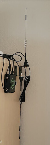

But while I'm waiting for Thursday (wife will be gone all day so I can blow things up w/out causing more WAF problems) I'm playing around w/a different Zigbee antenna. I thought it'd be interesting to experiment w/a spare antenna I had around (had come in a set of 2). They are dual mode Zigbee/Z-Wave like the stock C8 antennas. I had been using one of them on my C8 for Z-Wave for weeks now and it improved my Z-Wave results over the stock antenna on the C8, so decided to try the second one of the pair on my current C8 for Zigbee.
Started w/the new antenna yesterday late morning at power level 4 and things were a little better but some odd behavior (devices fully controllable from their Device pages would fail to respond to On or Off commands in an automation) so I upped the power to 8 last night. Since then things have been surprisingly stable/functional. I had one Aqara contact sensor fall off last night, re-joined it and it seems to be sticking, and everything else looks OK at this point. Also just had an instance of a light not turning off when the automation sends the off command...yet fully controllable from the Device page.
The changes are too recent to make any judgements, but so far no Zigbee reboots since yesterday morning, haven't had any other devices drop off the mesh, and automations all seem to be working. I'll let it run like this for the next couple days and see how it behaves.
The one pointing upwards is Z-Wave, the one pointing downwards is Zigbee.
