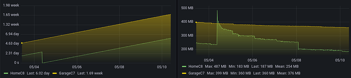

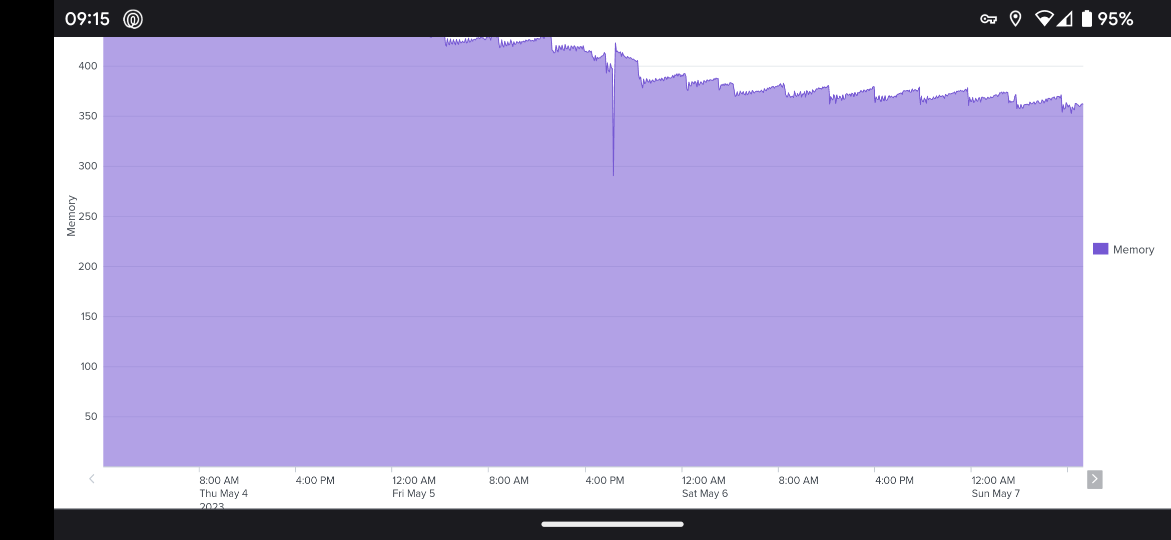

NOTE: The spike in both graphs from Friday is the reboot after updating to 135. I have the ZigBee device polling disabled. I checked the logs around the last major dip and there's nothing out of the ordinary.

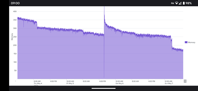

I think you're on to something. I have cloud backup set to 3:30 am weekly. That ran this morning and reports finishing at 3:32 am this morning. The big drop on the C-8 is reported at 3:33 am.
The only oddity is that I do not have cloud backups enabled on the C-7. The memory drop on the C-8 is pretty consistent, just also with that big dip when the cloud backup ran.
This is reproducible by manually running a cloud backup. Both dips in the graph are from doing so.

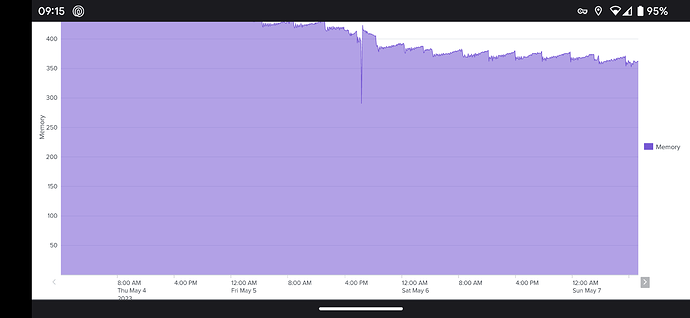

OK - this verifies what I have been seeing.
(insert pretty memory graph here)
When the memory gets too low on my C7, the Z-Wave radio will become totally fubar. The only way to "fix" it is to power down for 3 minutes and restart the device.
If I can reboot before the memory gets too low, I avoid any craziness.

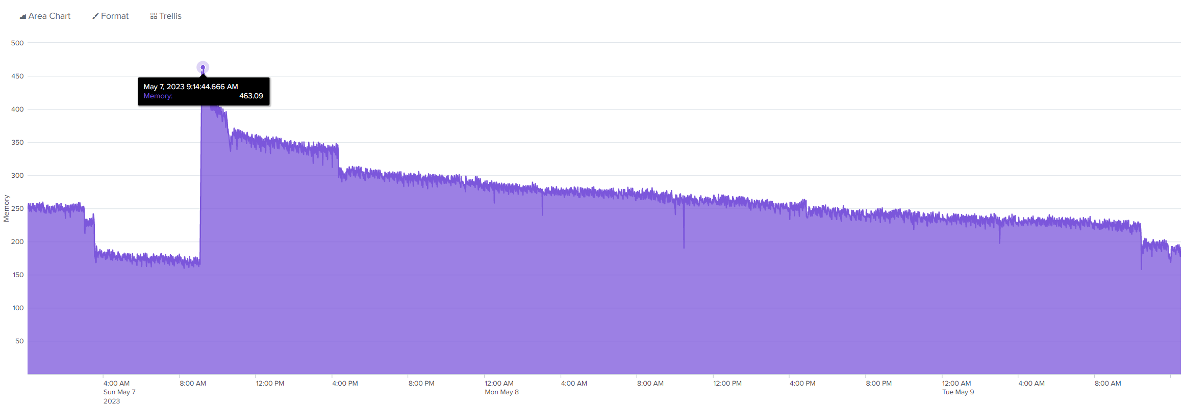

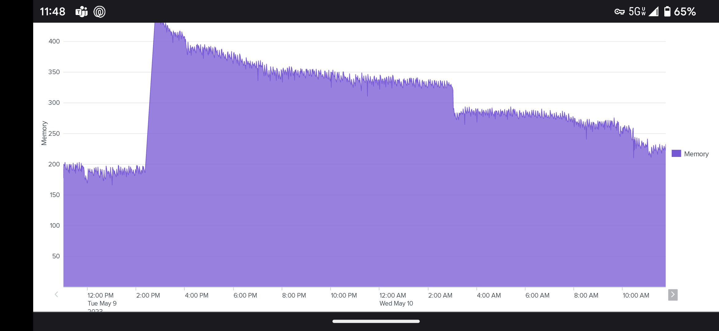

After today's cloud backup:
To recap since I rebooted on Sunday:

The C8 is still dropping pretty quick. I'm at 6 days and down around 180mb.

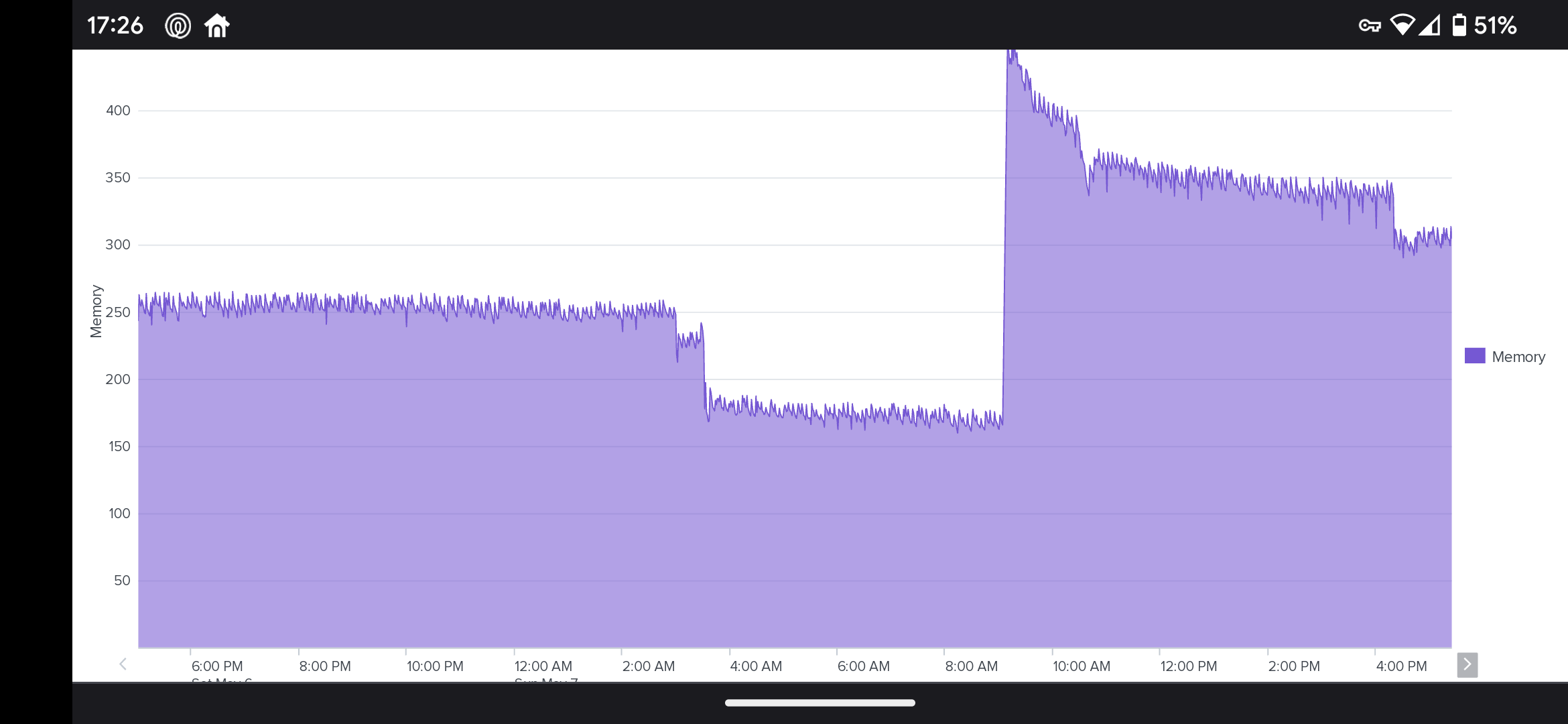

I also don't know what the database cleanup at night entails, but in the past I've ran it manually via the endpoint then rebooted. After that I'll have the most free memory ever.
Still tanking pretty hard. The drop at 3 am correlates to a local backup. I moved my cloud backups to 10:25 am. There's a smaller dip at that time.

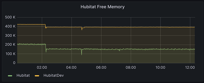

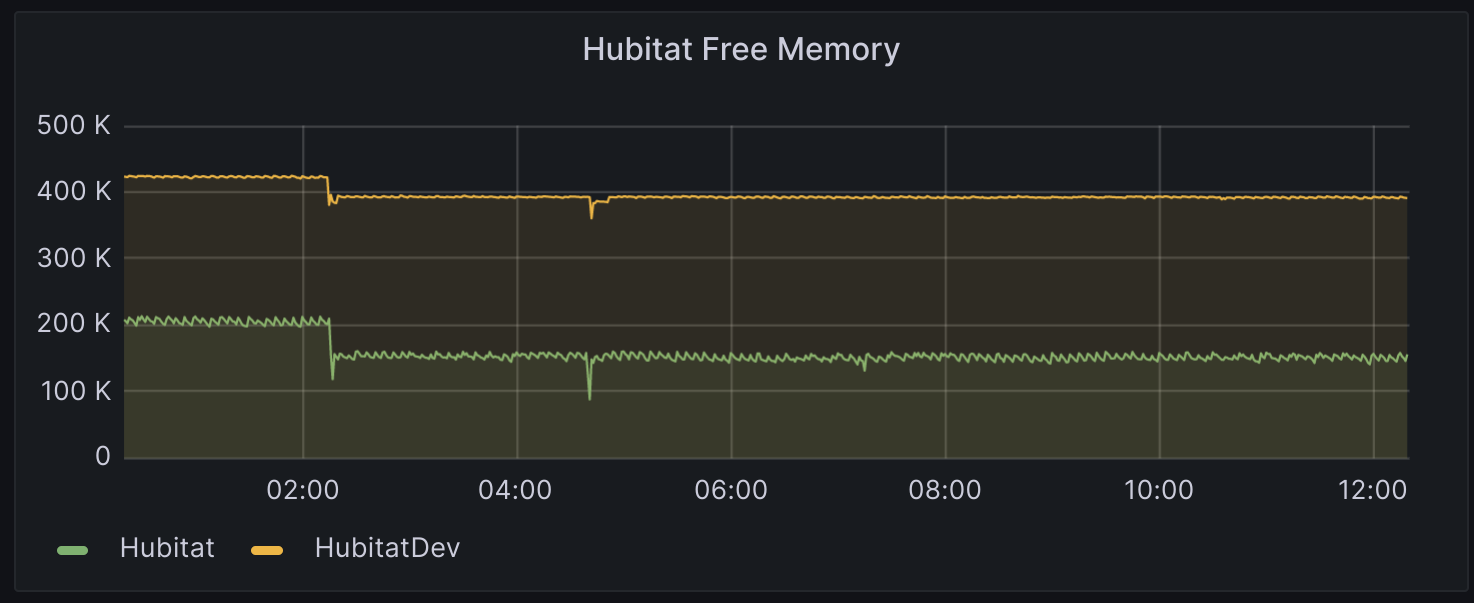

Here is mine in the last 12 hours. I have two backups that take place. The first one around 2:15am is the local backup on the hub. The one around 4:40am is when my Unraid server runs a script and downloads a backup. The second seems to have recovered the memory. The first appears to have lost most of what was consumed. I think it is also interesting that both my dev hub and my prod hub had decent size dips. The dev hub doesn't have hardly anything on it. Why it would have a big dip is beyond me.
