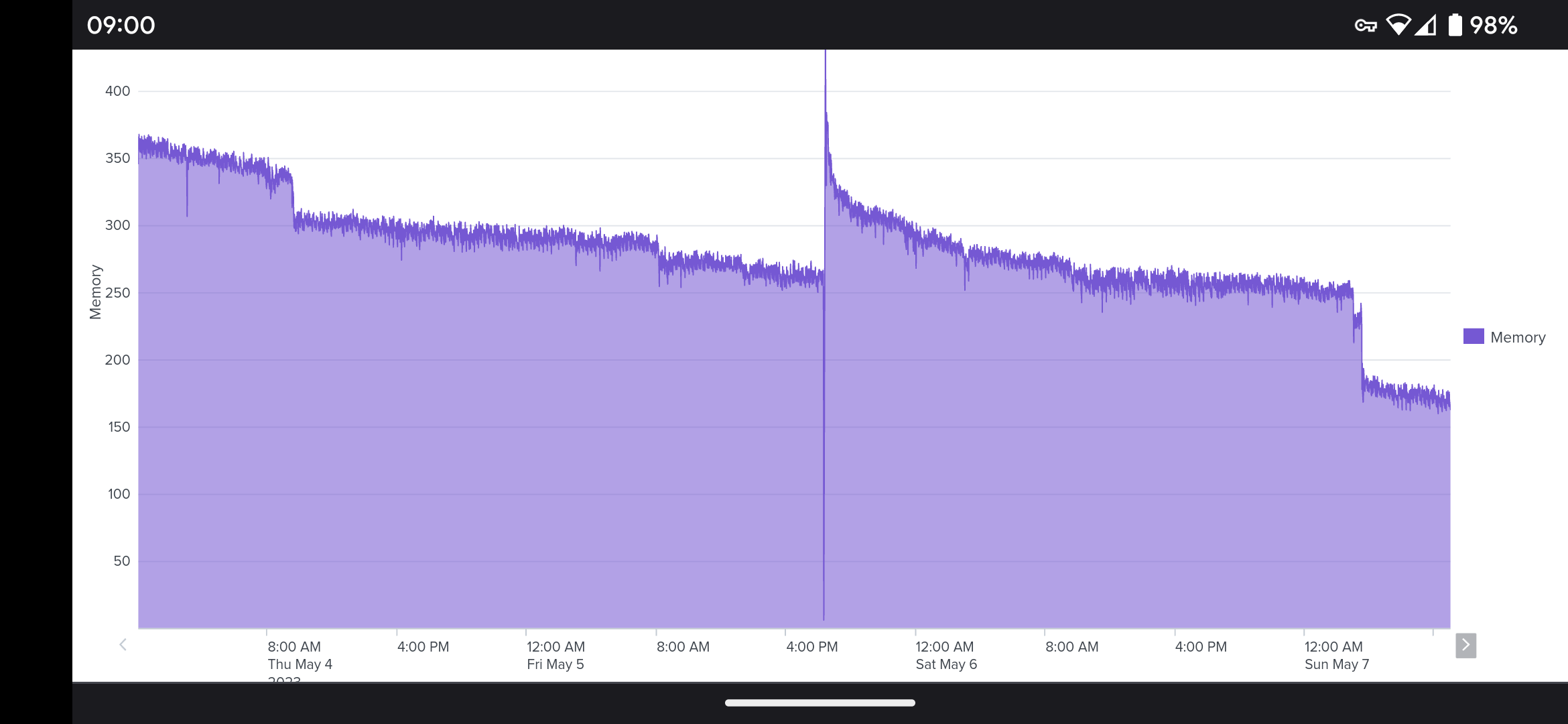

You don't happen to have the Hub Info driver where you can see what memory was at?
I do, but unfortunately (in this case), the events history is limited (10 entries), so only goes back about 1 hour on freeMemory
I'm seeing a memory drop issue whenever a cloud backup is done. I don't know how long it's been going on, but I can confirm it's there in 2.3.5.135.
