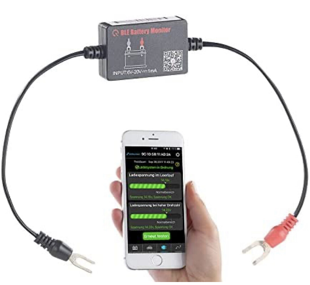

Seems like any 12V monitor that comes with an app uses Bluetooth, so Hubitat is out for those. However, do you happen to run HA? Looks like there is an integration for HA for the BM2 device, that could probably be brought into Hubitat with HADB.
