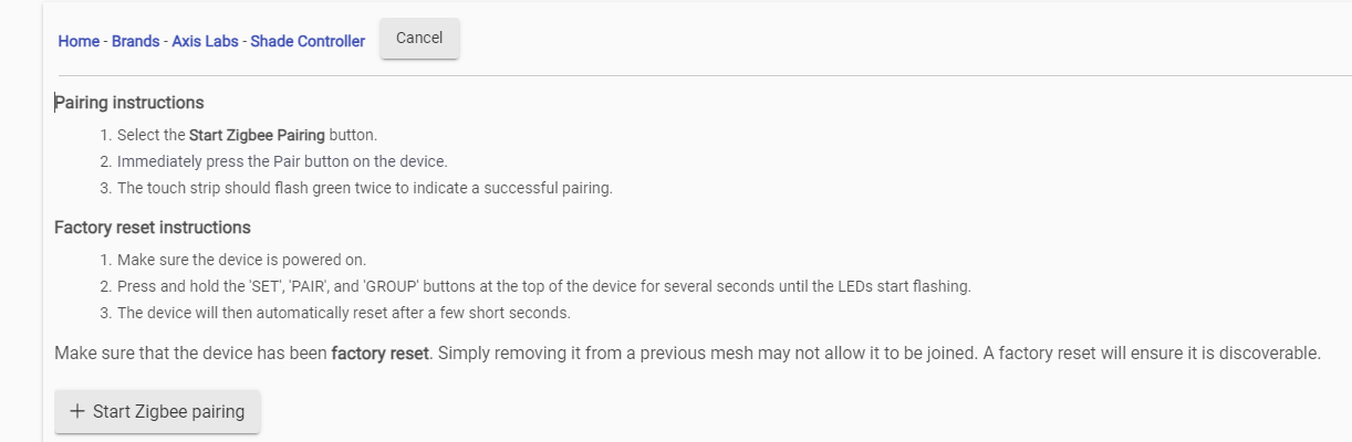

It's been awhile since I had to pair anything, but I have a Axis gear I paired last under generic window shade and that worked. Today I want to pair another Axis gear and I know it can pair because I can pair it in the app, I've factory reset it, but when I try to pair in habitat, it won't find it.
I start the zibgee pairing on the hub and then I click the "pair" button on the Axis and it won't pair, but it will pair everytime to the Axis app.
I’d read this thread for troubleshooting steps, and you may have a HW issue with your AXIS Gear. I’m on a C7 and i’ve never had an issue getting them to pair with hubitat after changing them from bluetooth to zigbee mode.
Agree with @sidjohn1. They (Axis) had to sheepishly take my units back to upgrade the firmware on their bench. Ever since they did that, they’ve been rock solid for me.
