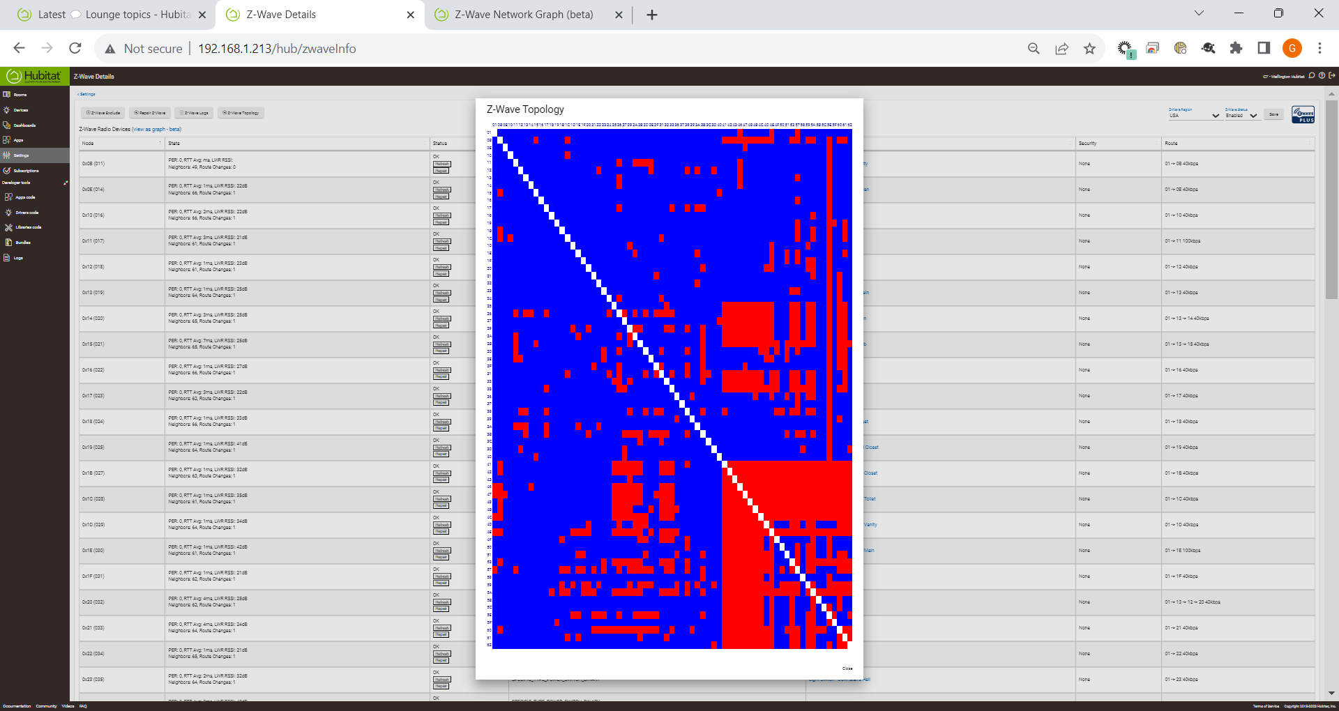

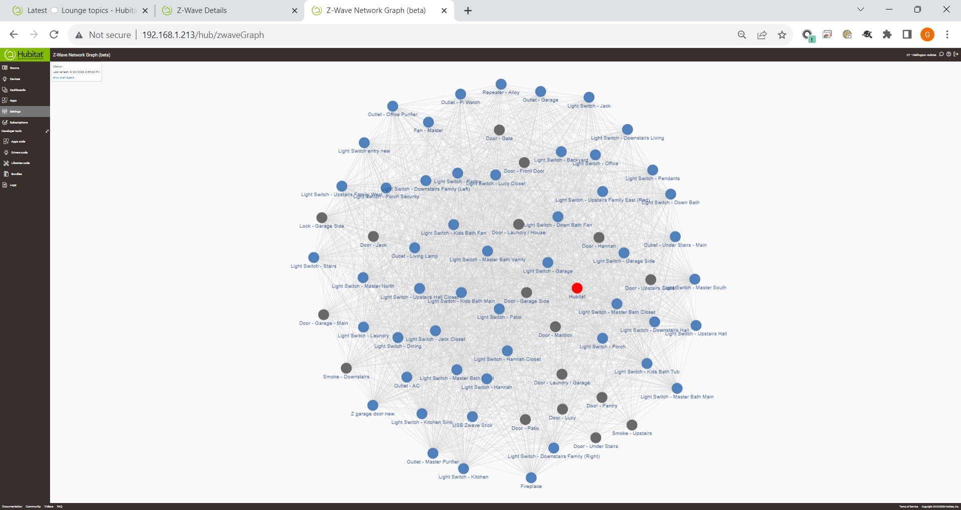

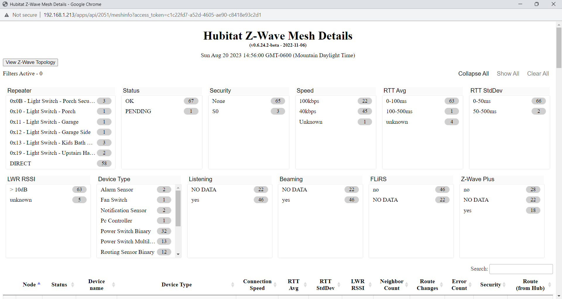

My network feels pretty solid aside from a couple contact sensors at the edge of my property that don't always stay connected. Seems swapping could reduce some 40kbps connections and would likely update more to 100kbps.
What are your thoughts? Replace non-plus with plus models I have on hand, or leave the system as is? What is your experience with reliability (capacitor failures) with the various models?

If you do have some concerns about the mesh, speed, etc. maybe one thought would to keep the non-Plus models on the old C5 hub?
