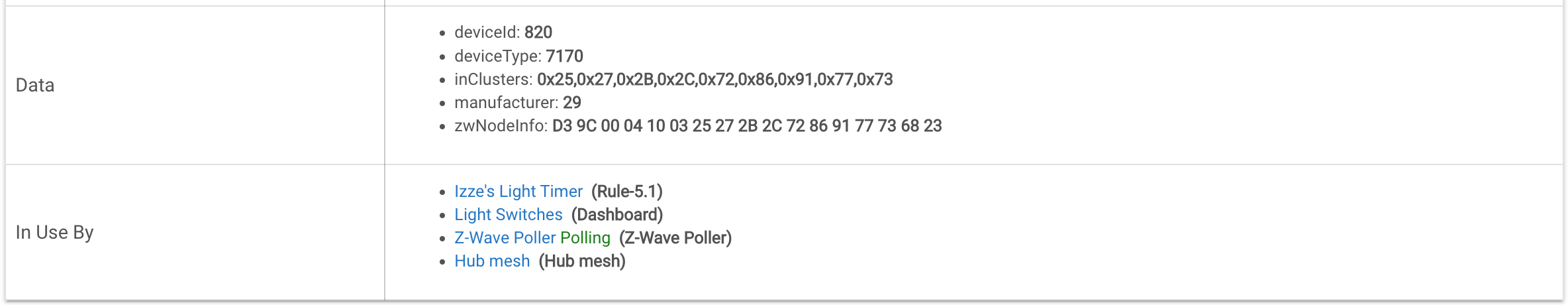

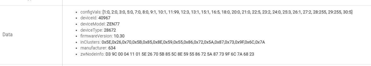

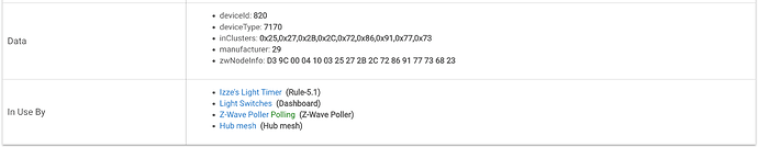

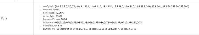

Probably Leviton? Knowing the exact model would help. Go to the bottom of the Device's settings tab and post screenshots of one of these.
Double edit, this:

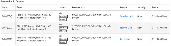

It would be best to post a screenshot of the complete Z-wave Details page from the Settings tab.

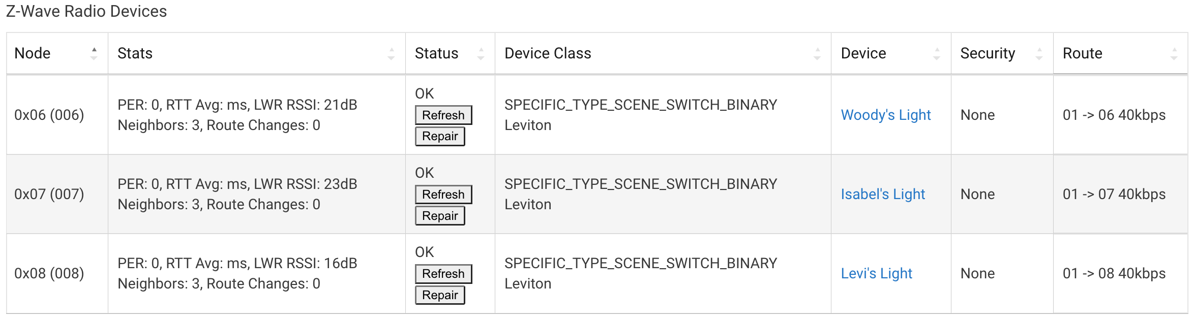

OK...I only have a few Zwave devices as I am still getting started. I did a Zwave radio wave reset and re-added my devices. Since I only had a few this only took me a few minutes and it got rid of my ghost nodes.

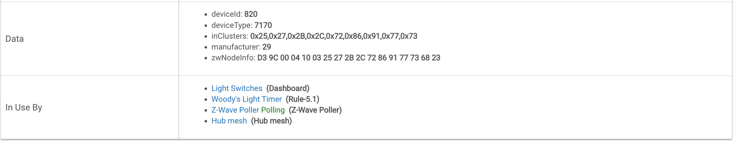

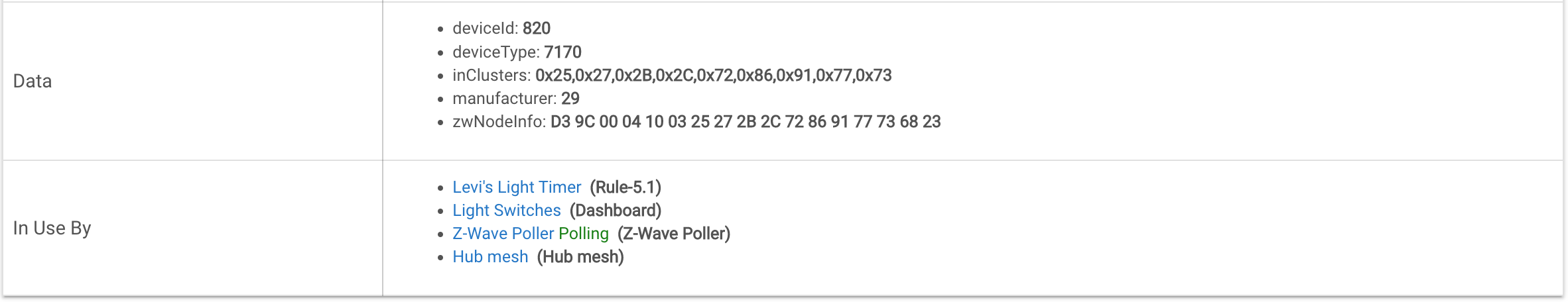

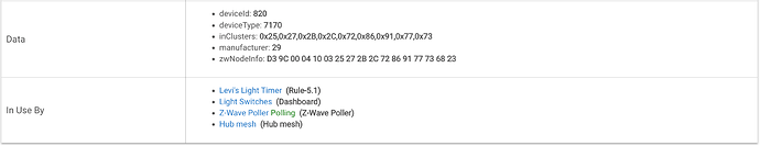

The bad news is that the Z Wave Poller still isn't working for some reason. Here are the new details for my devices and for the Z Wave.
