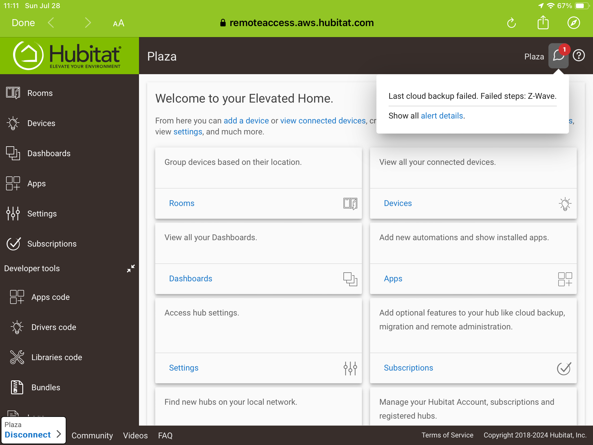

I have rebooted the hub a few times. I also have this error message displayed for the past 2 days.

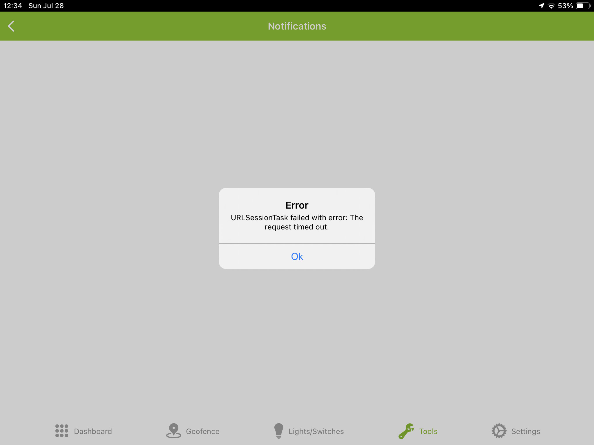

I did a « clear all events ». Logged out and logged back in. Tried to visualise notifications and rather than seeing the stale notifications I got this screen

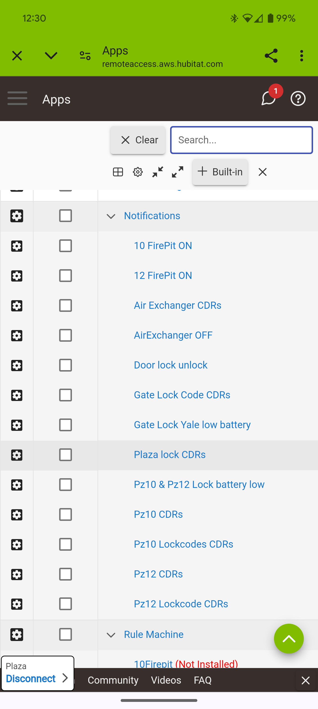

No. Log out of the app. Then from your pc go to yourhubip>>devices>>findyourphone(S) and delete. Then log back in and when prompted create the new device. Go back in to your individual notification rules and pick the new notification device.
I followed your instructions, logged out of the app both on my phone and tablet, from my PC accessed the hub and deleted the phone and the tablet from the devices tab. Logged back in from the phone and the tablet to recreate both devices in the hub in question. Then went to the specific Notification apps and added the devices on which I want to receive the notifications and still not working.
Is it possible my issue is related to the unsuccessful zwave backup which I referenced at the beginning of the thread. I still have the same error message today even though I followed the steps you asked me to perform yesterday?
I was trying to resolve your notification issue first. Now change your cloud backup to every 3 days and see if that helps. Perhaps @gopher.ny can look at your engineering logs for clues.
I just repeated the process per your earlier instructions. I rebooted before and after deleting the devices. I seem to have picked up notifications for Lutron integration devices. Added to the GE smart plugs that never stopped working. The notifications associated to the 3 locks are still not working.

From your original info that there was a failed backup due to Z-Wave, usually this means Z-wave crashed (or did not come back online after the backup). The current platform is much better at recovering from this situation but a few people still are running into it getting stuck.
That combined with the fact that states are not updating on the devices, I would say your z-wave radio is non functional at the moment. Either crashed, offline, or otherwise stuck.
With that being said, the only way to bring the z-wave radio back is a full shut down and unplugging of the hub unfortunately.
