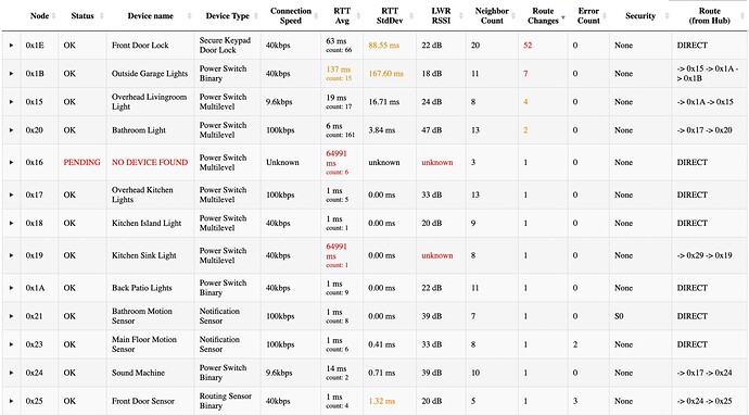

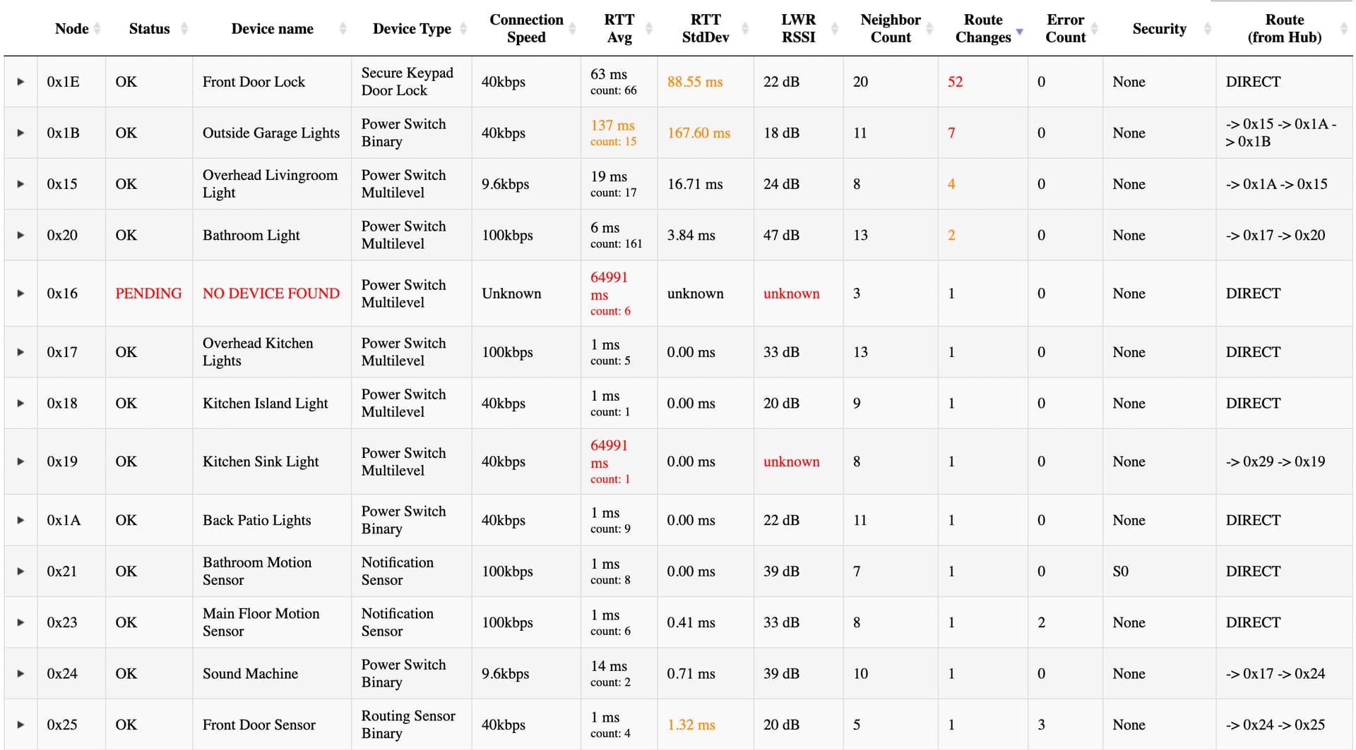

Can you post this from the native z-wave settings page?
He did earlier up above, I asked for it from that app because it shows more info.
I can see the lock has 66 messages and 52 route changes. Do you have a strong repeater near the lock?
Ohhhh, this totally makes sense! Yes I do. It's the dead front porch light switch haha. I bet it routed through that and is now confused. The hallway switch is probably 15 feet away, line of sight.
Not only is it confused but it having a hard time finding a good route. It must not be getting acks back fast enough or something so it keeps pining the network looking for better routes.
Normally pulling a device out the mesh would self-heal and figure it out eventually, but it looks like the lock was left stranded with no good routes to the hub.
If you get a repeater closer to that lock or just pull the batteries on it for now, the whole mesh will probably be happier.
