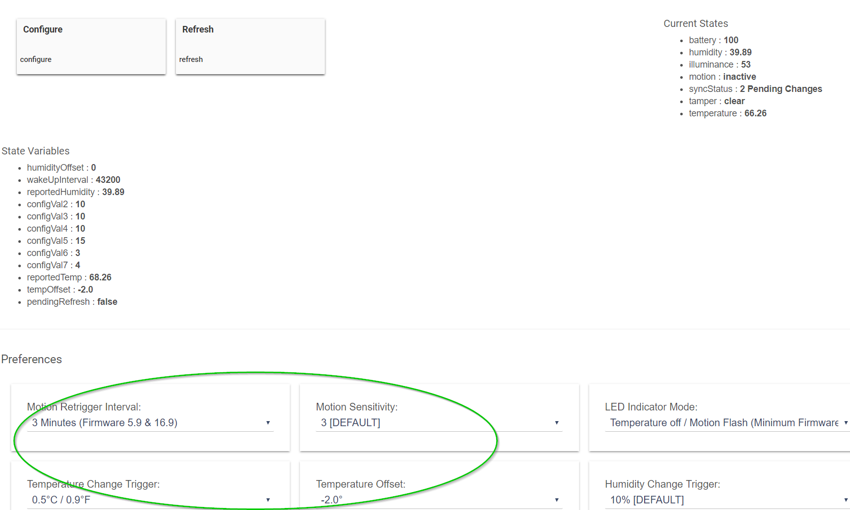

I gather these settings are only valid with the latest version of the 4-in-1? I've found that when these sensors get below 2.9 volts their response time suffers and when the z-wave mesh is anything but robust they don't register motion as fast as I'd like.
I've hard wired one of these sensors in a high traffic area where I wanted the best response time and did not want lights going off due to missed motion. When I set this one device to have a 3 minute retrigger it would eat up batteries.

No. Each setting that is different between firmware versions shows the supported firmware versions. For example (Firmware 5.9 & 16.9) shown in your screenshot. The data section near the bottom of the screen should show the device's firmware version.
I also see that the syncStatus shows "2 Pending Changes" which means that 2 of your settings haven't been sent to the device. If you enable debug logging and open logging before waking the device up you should be able to see which settings haven't been applied. It should also log warnings if you've selected values that aren't valid for your firmware version.
I'm not sure what firmware version you have, but 3 Minutes isn't supported by the 17.9 firmware so if you have that version it's most likely still using the default value of 15 seconds which would explain the poor battery life. I believe the valid options for the 17.9 firmware is 15-60 seconds.
If you have the model that takes 2 AAA batteries the battery life is going to suck no matter what you're using for the settings...
