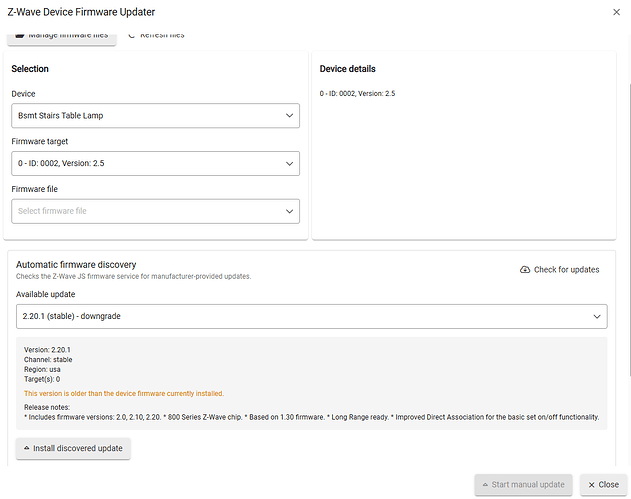

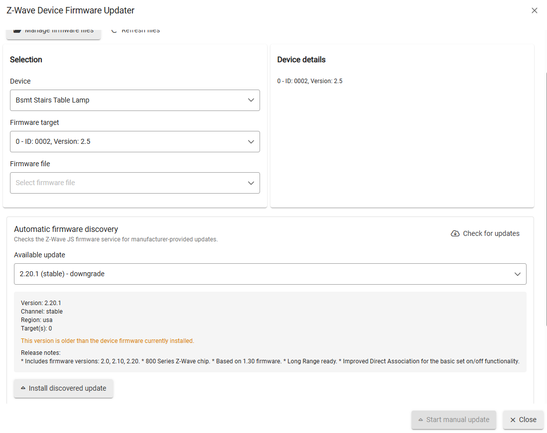

Might be a bug in the offered file subsystem. Or maybe just the repository is not updated?

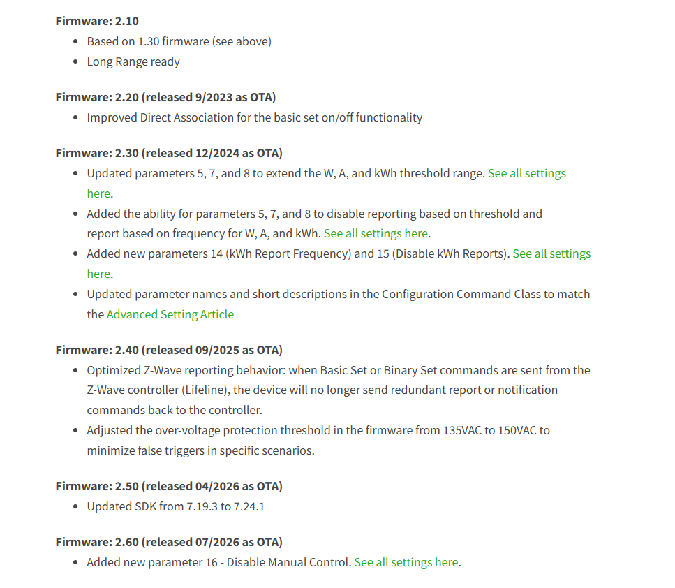

Device is updated to 2.50.1, Zooz OTA file at company website is now shows 2.60.1 for latest. Automatic firmware discovery wants to down grade to 2.20.1
I suspect repository is not properly updated but not sure.
It depends on the manufacturer submitting their firmwares.. Also… Make sure that’s the only version available.. That drop down should show other versions.. It could also be labeled as beta

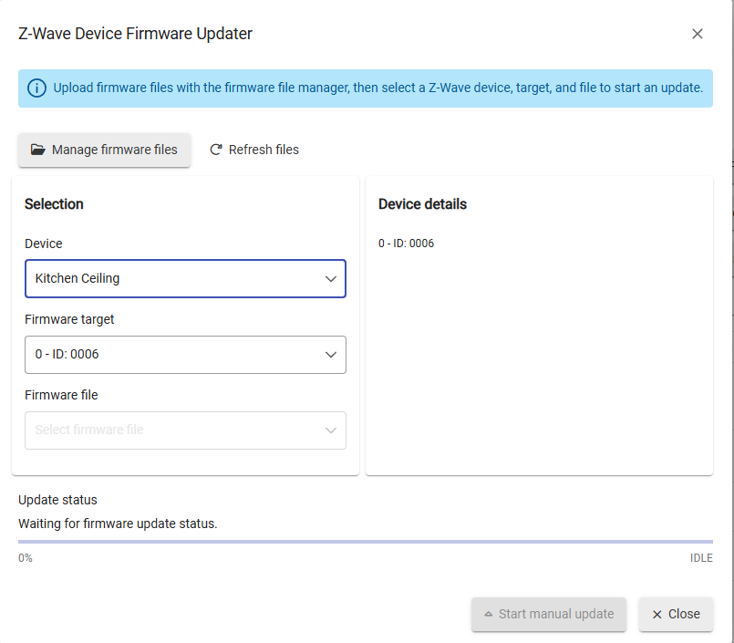

Just tried the newest ZWave device OTA updater. It has the much appreciated batch mode!! (cue the applause and cheering :clinking_beer_mugs: )!
I tested on a group of 6 ZEN76s I did in two batches (was too nervous to try the lot of them).
After that success I queued up my ZEN77s of which there are 20 so I crossed my fingers and queued up the whole lot. As of writing its almost complete the first unit.
Anyway I think this is a great improvement so you don't have to stay glued to the monitor and wait for one to finish before starting the next.
