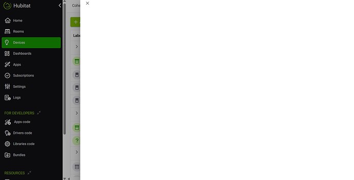

When the dashboard stops showing the actual status of the device i can't enter the device on the hub too...
I go to the devices page, click on the device, it opens the device page but its empty, blank white, only after a restart i can open the device page.

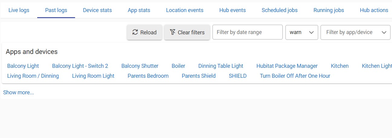

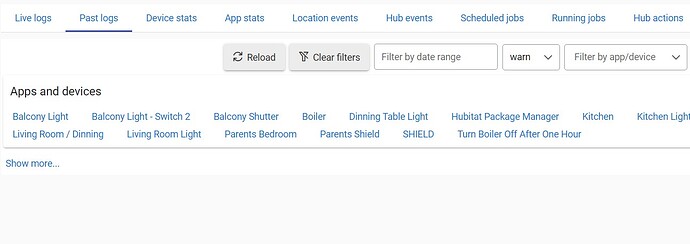

At least a few hours after rebooting get (and post) screenshots of the following. Just get the most you can of the info in one screenshot, don't need any more to start.

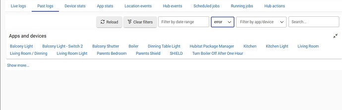

Logs > Past Logs -- Filter to Error Level
Logs > Past Logs -- Filter to Warn Level

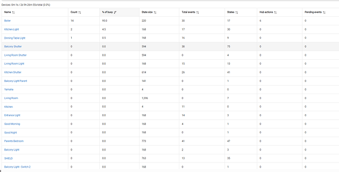

Logs > Device Stats -- AND Logs > App Stats --- Turn on all options in display settings, Sort by % of busy highest at the top. Include the stats above the table in the screenshot.
Hi, Thanks again...
Trying to pin point and make it easier i've disabled all zwave devices except one and restarted the hubitat, problem is back again with only one device enabled...

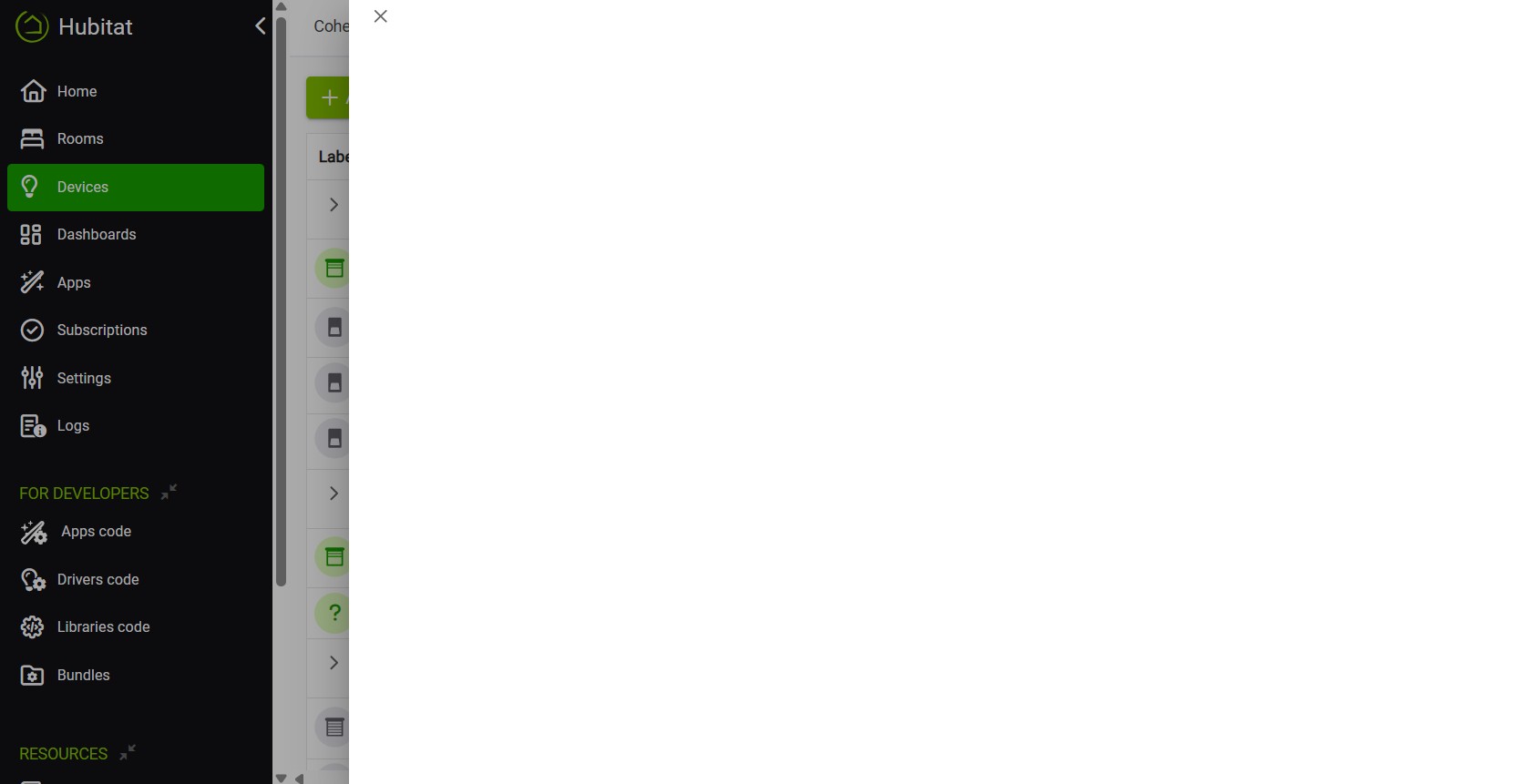

attaching screenshots: (last one is the blank page i see after i click on the enabled device)
Highly unlikely it would be a zwave device causing the problem.

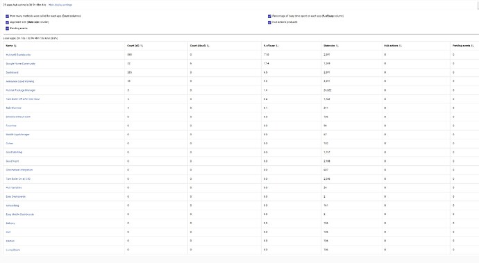

Also, you showed device stats, I wanted to see app stats too.
Hi, right!
My Hub is the C7...

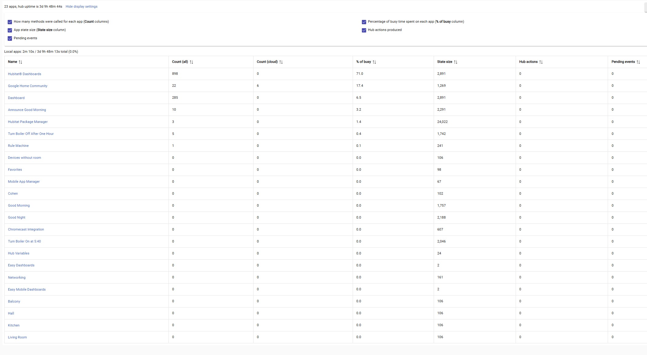

Attaching the App stats :slight_smile:
Thanks.
Your hub is quite inactive and boring, does not seem like it should be overwhelmed in the slightest.

Still, pressing a device loads a blank page.

Thanks for the clarification, I've tried 2 different computers and my Cell phone and all opened a blank page while pressing the Device...
